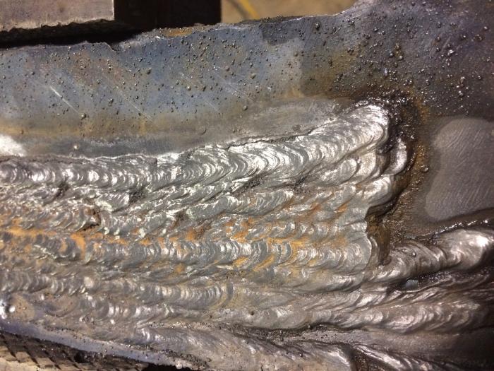

Anyone have any luck running 6011 on this machine? I see Jody doing it on the videos but mine will light up and catch fire and burn out after 5-7 seconds. It will run a 6013 well, and a 7018 pretty good. I'm not a great stick welder so any help is much appreciated. Thanks

I got mine to run 1/8 6011. I do run it on 220volts. I can't remember what my settings were. I usually use a diferent machine for my tig and stick work. I can give it a try again later this week and post the settings.
- IMG_0272.JPG (81.43 KiB) Viewed 7778 times

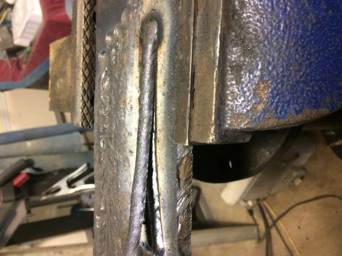

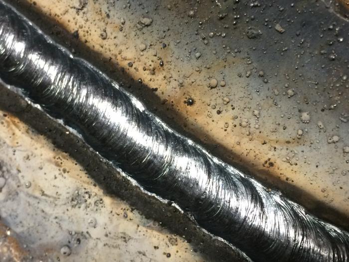

The 1/8 6011 that were in question I was able to run at 115-140 amps with a hot start of 5 amps. I also varied the arc force from 3-10. This machine will run the rods nice , but is very fickle about arc length. I went through about 5 lbs of 6011 1/8 and was able to duplicate what you described. It comes down to arc lenght. If you can't feel the rod touching the base metal then it's about to drop out. I tried push and pull as well as odd angles and got the same results. I did check the digital display on the machine after thearc drop out and noted that it only ever puts out 29.9 volts max. Think that's why it has a hard time with 6011 and 6010. Side note the nice slag was from an 1/8 6013 and I had similar results with the 7018 and 316ss.

Those inverter machines dont run 6010-6011 very good. Definitely not 6010 but it should run a 6011 better than you are describing. Your going to have to watch arc length and the amperage range for 1/8 6011 should be 70-120. Maybe try different brand
I have 2 inverter based machines that both disagree with you ("don't run 6010 very good"). My Dynasty (2005) runs about a sweet stick as any machine I've ever used, and my small MultiMatic does an amazing job for what it is (portable, multi-function). It has a menu to switch between rod types to internally set weld parameters for "Dopey Welders" like me.SchweiBer wrote:Those inverter machines dont run 6010-6011 very good. Definitely not 6010 but it should run a 6011 better than you are describing. Your going to have to watch arc length and the amperage range for 1/8 6011 should be 70-120. Maybe try different brand
I agree it's not because it's an inverter. My TA 186 and all the millers at work run 6010 just fine. But the the 210mp is geared more towards Mig. That's what I bought it for primarily. It did run the 6010 and 6011 it just wasn't very forgiving about arc length.
