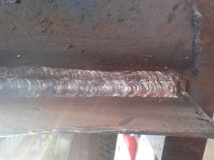

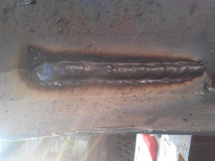

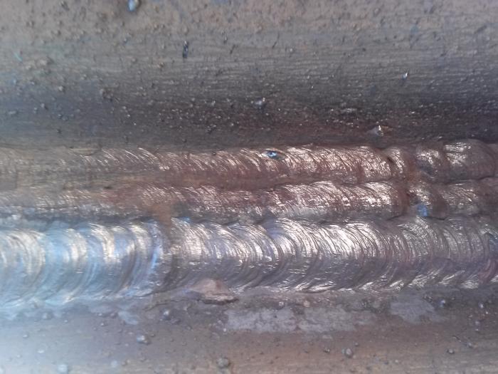

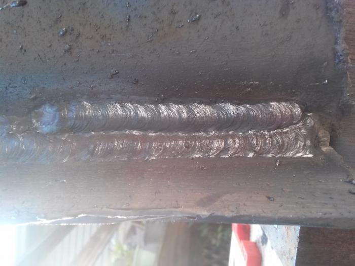

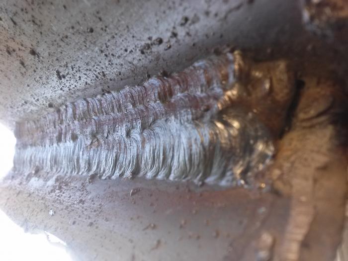

I practiced on some real thin plate yesterday with 3/32 7018. From 90 to 95 amps. I'm putting these up even though i dont even consider myself in the same league as most of you guys...AK and Jasper and MANY others. Im on summer break from school and I was dying to light up and melt some metal. Couldve held the toes for a little longer and tied into the previous bead better, but thats why ya practice right?
When i preview it shows the pics horizontally for some reason but theyre vert up

Hey, not bad.
Looks pretty smooth.
And I'm no professional. Lol
    Fri Jul 11, 2014 8:30 pm
    Long Island NY
Yea it served its purpose as good practice.
I dont have alot of experience with big weaves like AK's and its nice to get to see some done right. They come out looking great. Maybe ill try some of those out next time too.
