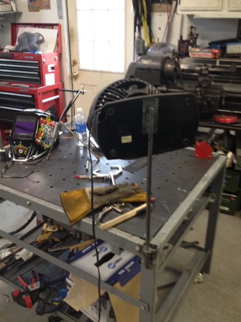

i needed to do something about fumes
while trying to remember how to stick weld.
prob not OSHA approved but easy to remove...
- IMG_1667 fan arm .jpg (122.65 KiB) Viewed 978 times
Oh yeah, I am sure you don't want to breath a lot of that stuff. when I use 7018, I throw open the garage doors, and I have a pedestal floor fan at my back, pushing the fumes out the door. if the wind ends up pushing it back at me, I revert to a respirator.
