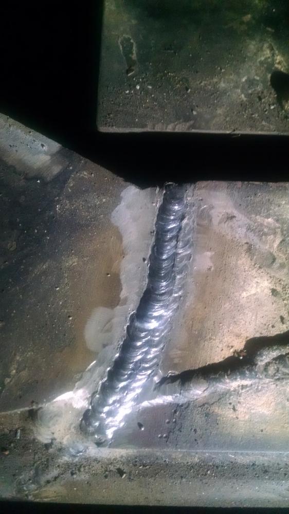

Had a small improvement to do on my new Caterpillar 924K. Had it in front of my shop today as the dealer came to do its 500 hour maintenance. Machine has automatic lubrification so all pivot points have hoses attached to them. The ones on the lower boom, where the quick attach hooks up were sticking out very much and my brother and my uncle both managed to break one off over the last few months. So I made a protective case to avoid future "accidents". Had some heavy scrapiron laying around so made that work.

Some vertical up, 7018-1 3.2mm

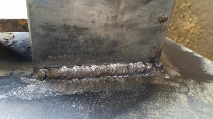

Welded on some logging equipment this weekend. This is one bigger weld of the bunch.

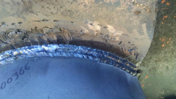

I know I'm late to this topic but I have a pic of a new blade I put on a loader for logging. It's used to de-limb trees.
    Fri Apr 01, 2011 10:59 pm
    Australia; Victoria
Try and avoid the flicking motion with those electrodes. It looks like they are a GP, or even 7018, and the flick will trap slag. Keep the flick for 6010s/11s.
jroark
    Thu Jul 16, 2015 2:39 pm
    Ramseur, NC
They are 7018's. Thanks for the advise. I mig weld all day and on the side I work on repairs and I have to get out of the mig mode and try to get in the stick welding mode. Takes me a few passes to get in a groove. Thanks again.
    Australia; Victoria
No problem. 7018 only need a straight run, or maybe a little side to side weave. Not forward and back. And I mig all day as well, so I feel your pain. Lol, Mick

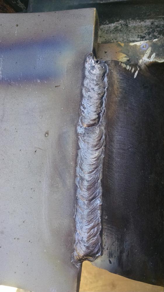

Haven't had to weld in the vertical position for about 2 years now. I did not have a wire wheel handy so I had to use a regular claw hammer and wire brush . Any comments are welcome.
1/8 inch Lincoln 7018 at 85 amps Dcep
