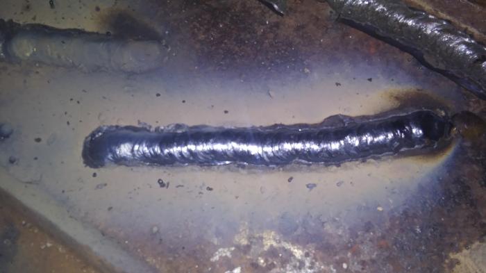

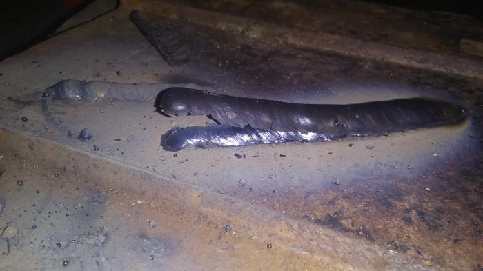

After jackin around a bit I finally started getting nice looking beads and "peelers."..with the 7018
They are Lincoln 3/32. It says to use 65-100 amps, but I couldn't get a stable arc on 1/4 plate steel unless I turned up to 120 amps. 100 amps seemed week. 110 was a little better, but 120 seemed to be the sweet spot.
Is it common to have to turn the amps up out of spec to get a stable arc? The pics I attached are 120 amp beads on 1/4 steel.
My machine is a Sungold arc200

I seem to be likin that weld Dan. I think that the machines of today are only in the ball park of getting the settings. I really don't know if they are all "tuned" to be the same when set at a particular number on the dial. I think it is all what works for YOU.
Stay safe, warm and healthy.

Thx BillE... Good point about the machine amp dial too. My little inverter didn't run 6010 or 6011 very well on the recommend amp range, per the dial setting. Perhaps if I kick the amps up on the dial I'll have better luck... Going to try it.. :geek:

Could just be a calibration issue with the machine. With 3/32" Lincoln Excalibur 7018, ive used 75-95 with perfect results.

My miller Dialarc like about 115 amps for 3/32 7018, won't hardly run them at less than 95.
Tap the rod on the concrete floor when it's still hot, works pretty good for restarts.

Never had to use anything over 100 amps for 3/32 7018.
My idealarc 250 likes 85-95 amps on DC+ polarity for flat welding. For vertical up, I’ll run 80-85 amps.
