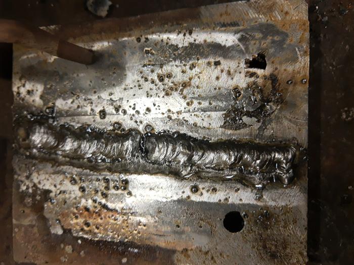

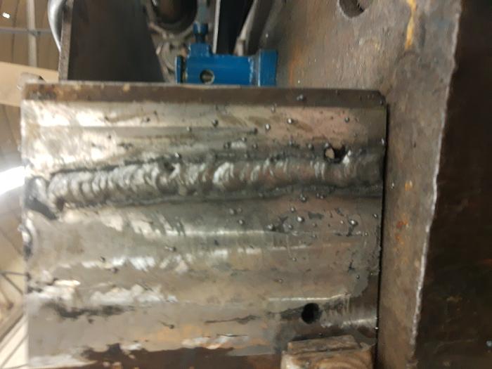

All this talk about 6013 I figured I had found a box of them laying here so I would run a few beads.
- 16010616868662088483453796215402.jpg (74.53 KiB) Viewed 7923 times
- IMG_20200925_150200789.jpg (63.36 KiB) Viewed 7923 times
