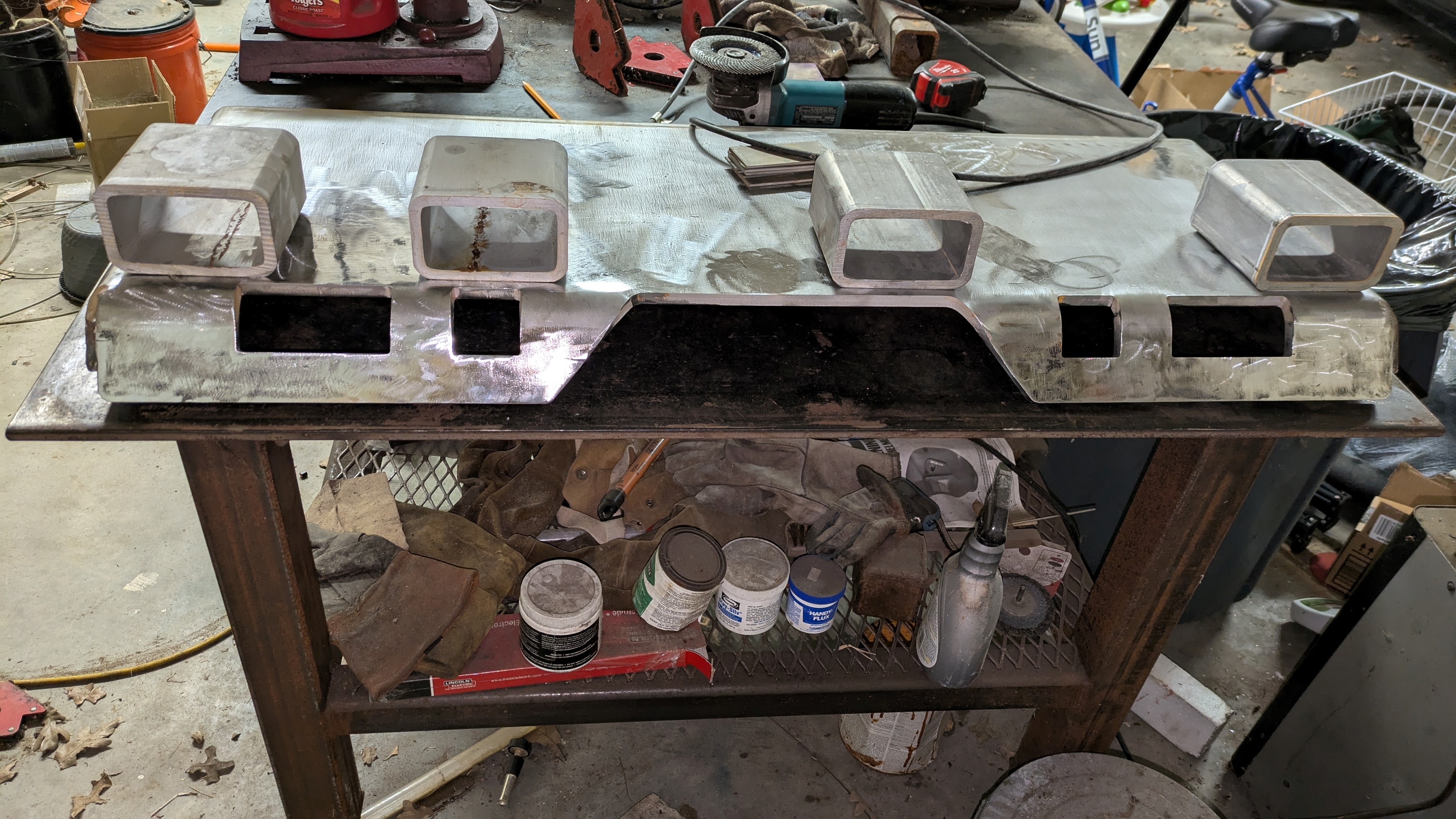

Greetings. I am working on a pallet for for my tractor front end loader. I purchased a 1/2 inch thick mild steel skid steer plate. I need to attach tines to it. I bought some 3x5 inch rectangular tubing with 3/8 inch thick walls and cut it to 5 inches. I want to weld these pieces of tubing to the skid steer plate.
The top and bottom welds will be easy because they are simple lap welds. The side welds will be more difficult for me because the tubing is curved. I hope you can see that in the pic.

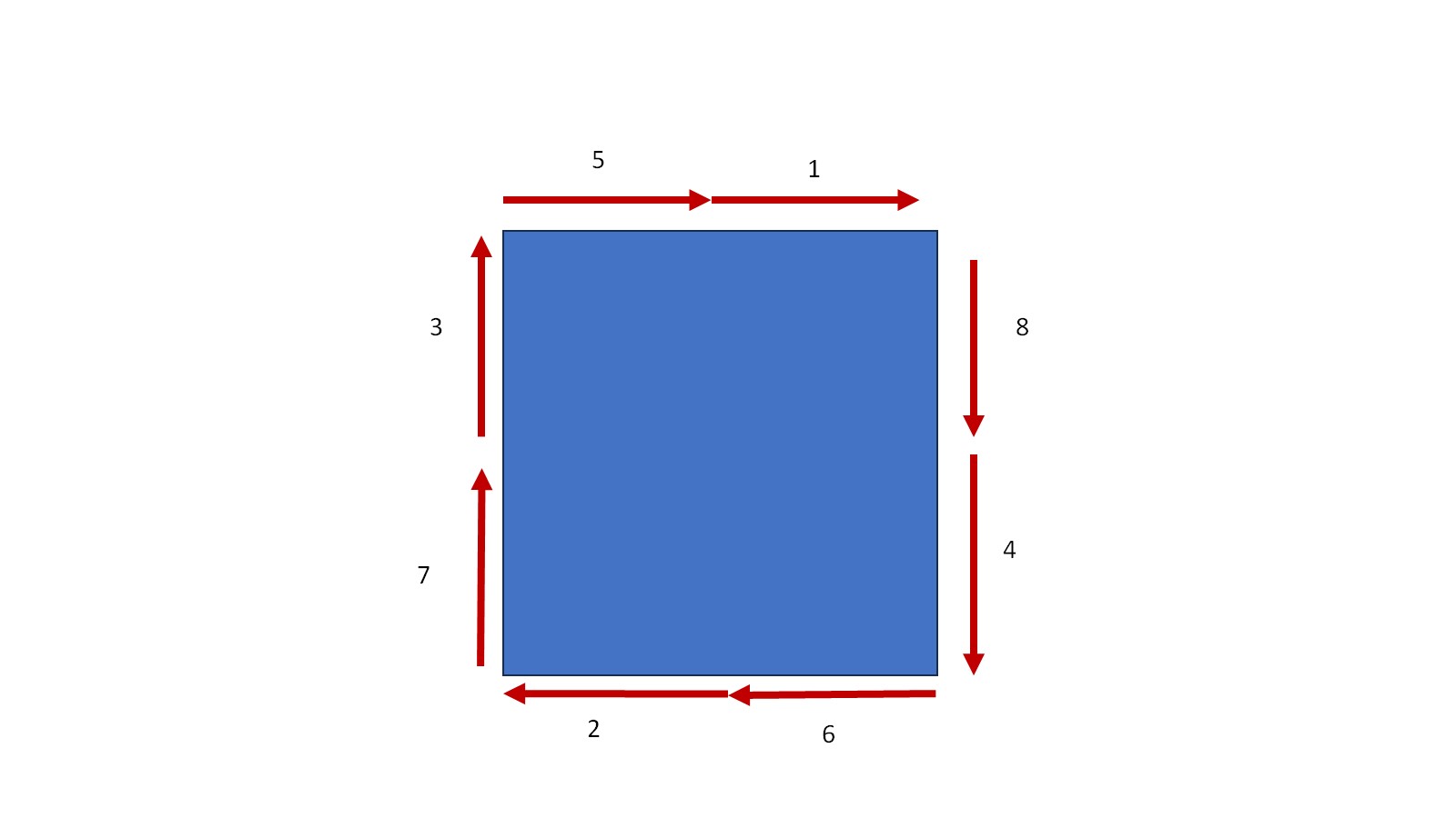

This is my plan: 1/8 inch 7018 with an old Linde 305 welder. I do not know the amperage because it is so old it does not have an amperage readout. I want to weld around the tubing in 8 short welds. The direction of the welds and the sequence is shown in one of these pics. I plan on two passes. The first pass will be a simple straight drag. The second pass will be a Z from side to side and will follow the same sequence as the first pass. I do not know if this is a good plan or not. Any comments or advice would be helpful.

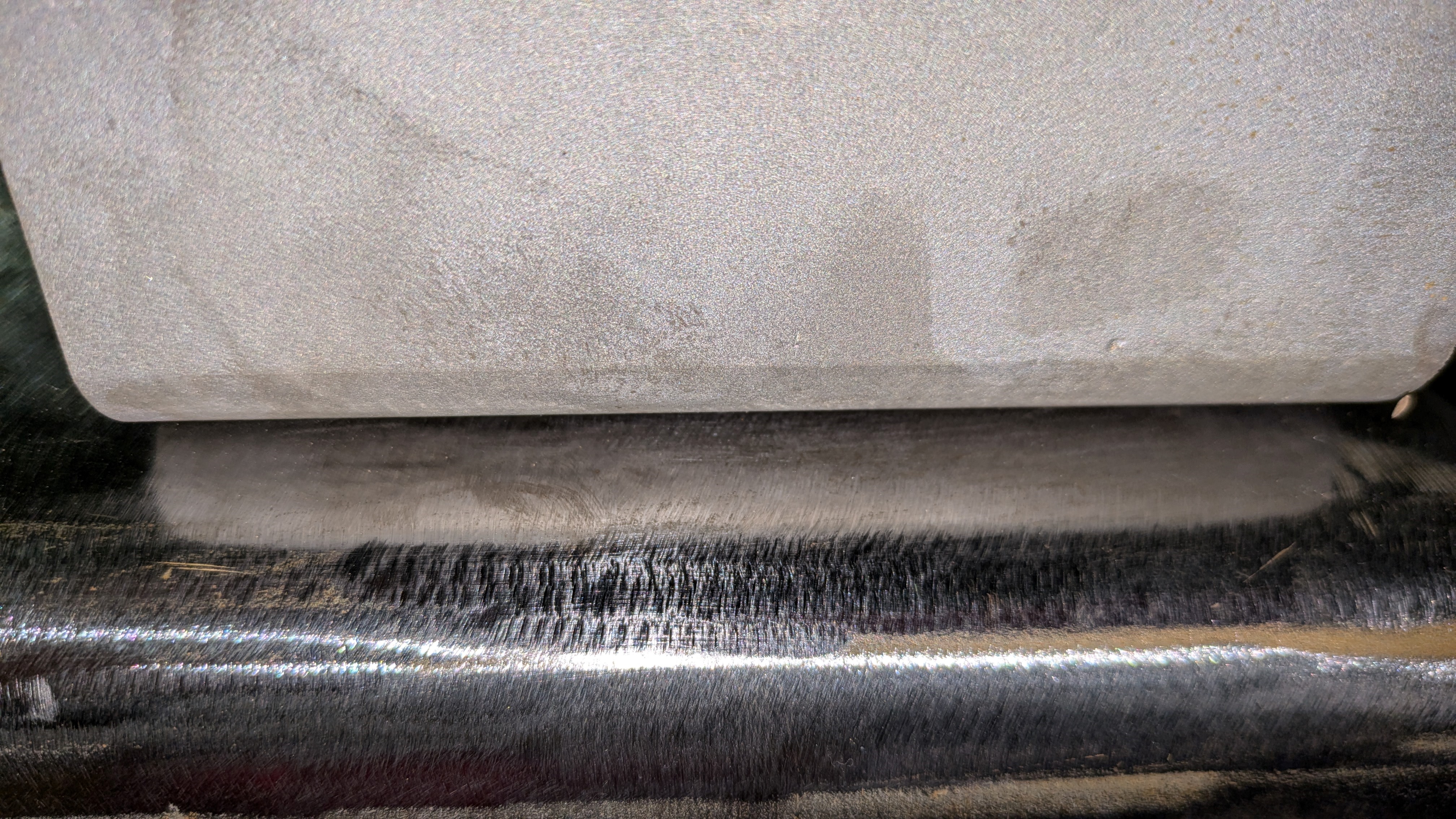

My desire for two passes was to prevent what happened with my original pallet fork shown in the pic. It was a factory weld and the plate was 1/4 inch. Maybe I am overly concerned with this one. Do you think the top and bottom welds still need two passes?

Normally, the reason a weld like that fails is the end of the weld doesn’t wrap around the edge of the plate. For your tubes, if you weld them around fully, then I see no need.
Think about that failed piece. If there is shear stress applied, and only one side is welded, then the vertical piece is weak. If you collide the horizontal plate into something hard enough, or drop something heavy on it, all that impact stress is applied to a straight, incomplete weld. You want the vertical pieces to be fully wrapped to prevent them from tipping against a fillet weld, being pushed backward from a frontal strike, or having to withstand all the force of a load directly by a single weld.
If you want to 2 pass it, feel free. But a single, proper pass that fully encompasses the tube should hold the whole world. 7018 rod has a tensile strength of 70,000 PSI. If your forklift can break that, you need to take some operators lessons

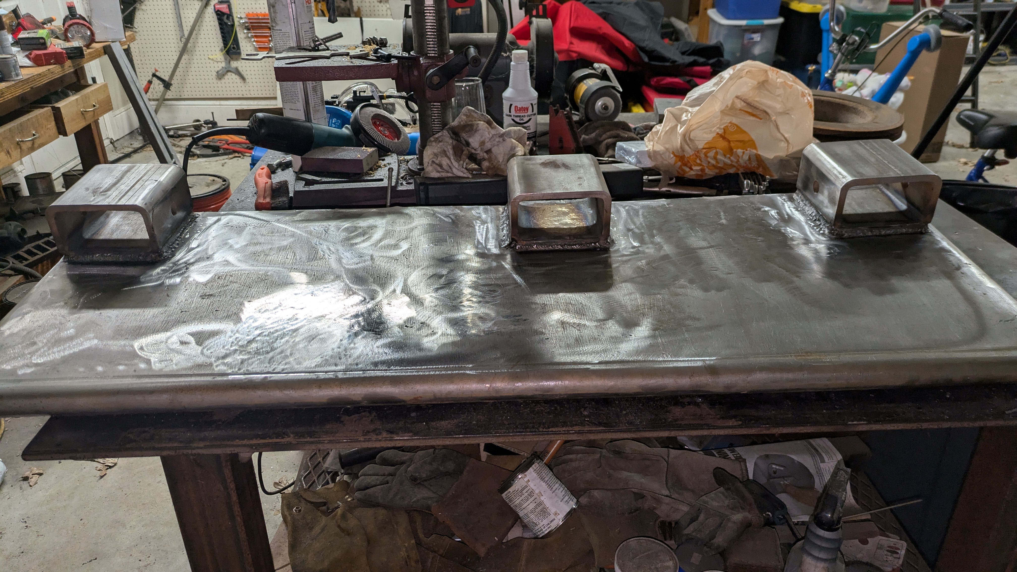

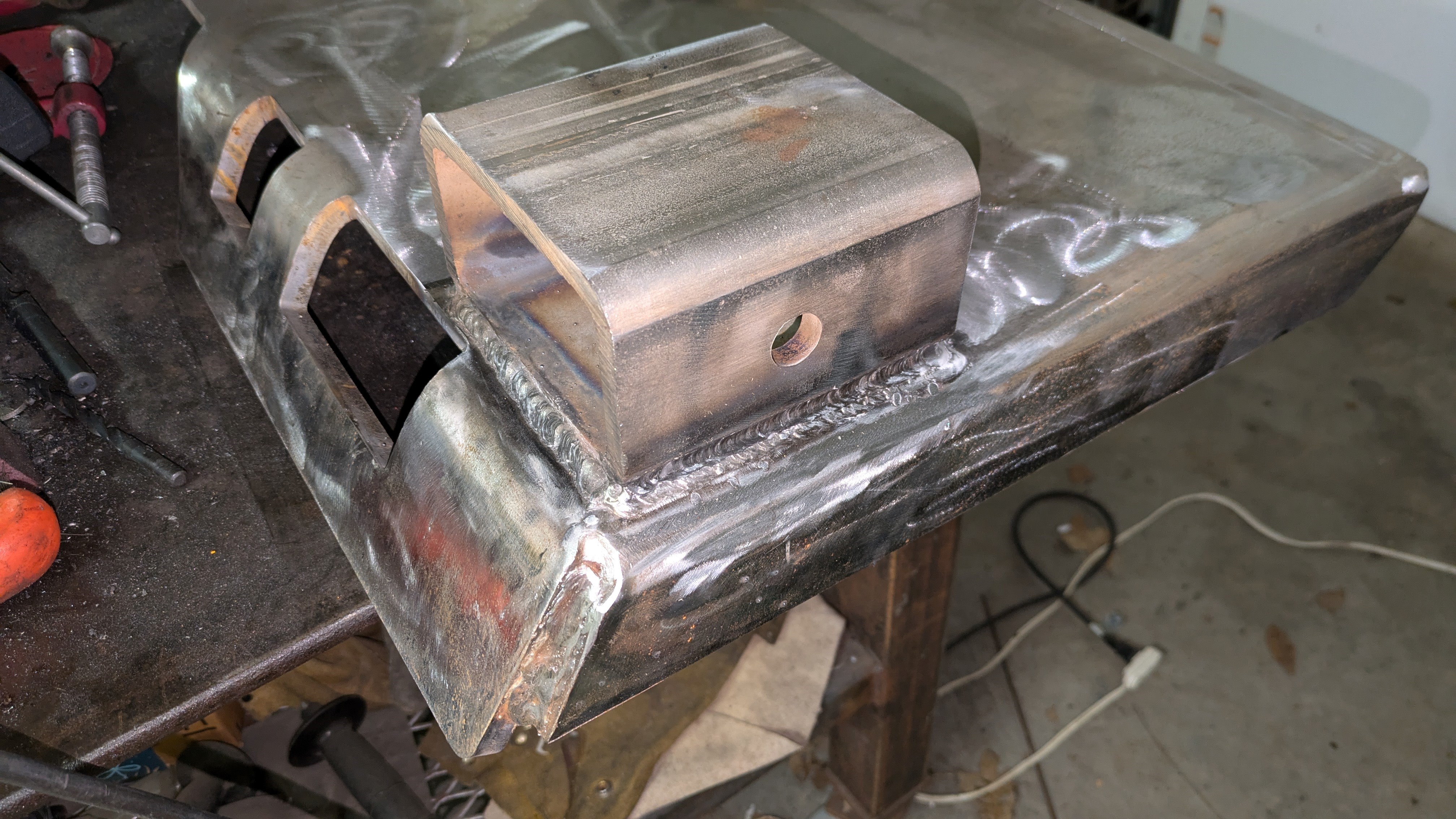

I made the welds. I chose 6010 to get penetration on the sides with the curve. I left the top and bottom with 6010 only. The sides filled in with 7018 mainly for looks, but it will add strength.
I have three time holders and they are offset on purpose. This gives me a 39,23 and 16 inch spacing on my tines.
The factory weld that is very thin in that corner bothers me. I think I will fill it in with 7018. I also need to cut the headache rack off the old pallet fork and weld it to this one.
The tines are a little loose so I want to weld some 1/8 inch spacer plates to the tines to tighten it up. Then I will paint. It takes me awhile because I can only work on it on the weekends and I am slow.
