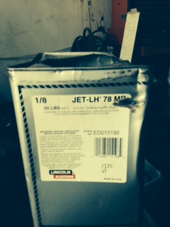

I was trying out some Excalibur 7018 1/8 today for the first time down flat on 1/4 t-joints with my Invertec , 125 amps , going back and forth from Excalibur to my Jet LH 78 and I must say I don't think the Excalibur was doing any better than my Jet LH 78 :o , I don't like how flat the tip is on the Excalibur makes it kind of hard to strike at an angle , and the slag didn't come of very easy , a few taps and it came of , but my Jet LH 78 the slag curled up in one piece and the weld had better wash in , the Excalibur was more prone to crowning up with a tad of cold lap , noticed a little heavier slag coating around the puddle and it was sort of getting in my way :?: , while my Jet LH 78 :? has a lighter slag coating and the puddle was easier to control , I was running both of these rods equally as I could ,both out of my 250 deg oven and my Jet LH 78 just seemed to do quite a bit better , don't know if it was just me or what :| thanks John

Re: best brand of 7018, by experience only
Posted: Tue Dec 24, 2013 11:27 pm
by AKweldshop
Best brand of 7018, Right here Folks 8-) 8-) 8-)
I can take all the criticism you guys can throw at me :( 8-)
