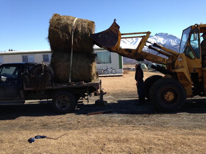

Next thing is bend the hitch back-up.
And yes, I don't mess around.
It took 4 guys and 3 brains to get her done.

John.
Not to sound dumb, but why didn't you just push down on it with the frontend loader instead of messing with the round bales?

Braehill wrote:John.
Len,
I was not the boss here.
But, we were moving bales today, and we had set one on the bed to haul when I'm done.
And it made for a cool pic.
We thought the bales would be enough weight to jack up.
But the jack lifted the whole truck.
Not a dumb question at all.
~John

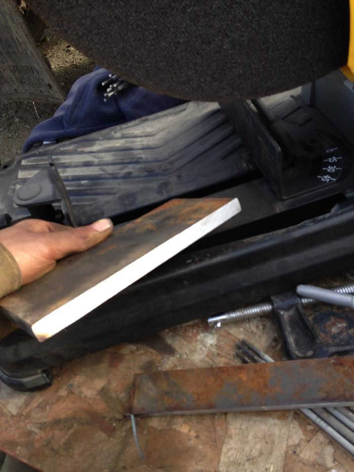

Using a piece of 1/2 in flat bar about 6in wide too even up the bottom to put the tube back on.
More pics to come.
~John
