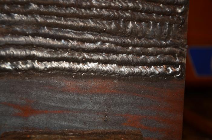

Hey everyone, as you know I am a newb and each day I practice weld I have thoughts and ideas. Today I was practicing and lowered my amperage to find that my slag now pretty much falls off on its own.
My question is: Can we judge our weld by the slag? Another words, if the slag just about falls off by itself and is not burnt on to the point where we have to "beat" it off does that in fact mean that we have a "good" weld with enough penetration and adhesion?
Here is a pic of my latest practice (photo of bead pad), I think I am getting better now as I look at the pool and not my stick. Like I said, any good advice on how to hold the rod, stand, where to focus my eyes etc.. would be really appreciated. The other pics are of stuff I have made in the last week, the welding table I got from the local scrap yard and then purchased the casters. I think I will add a 1/4" top plate as I think the top is just a little to thin... will 1/4" be thick enough?

- A lot of porosity, electrode angle???
- DSC_2349^.jpg (49.12 KiB) Viewed 10070 times

I don't know a lot, but it looks like you're doing very well. Which electrodes are you using? The Slag should easily flake off with 7018, when you get everything just right. Then write down what settings you were on and what you did for that to happen, lol.

Try to overlap the rows, more than that. You don't want lines between them.
Which Amperage and Electrode size and Type did you use?

You can definitely tell how a weld went in by looking at the slag. But when It just peels right off like that, your travel speed and heat are set just right.

Nice bike first off. Second, like others have said the slag pealing off like a banana does in fact show good travel and heat, however a weld that you have to chip, not beat, off does not mean it is a bad weld. From my experience there are ALOT of normal weldors out there that do not have the slag peel off and their welds are holding just fine. Really, just because the slag comes off does not mean you layed down a deep penetrating bead or hit the joint like you should. You can lay a bead on the surface of your substrate and have the slag peel off but it is not a deep penetrating weld. What I am getting at is just because you can magically make the slag peel off behind you does not necessarily mean it was a perfect weld (think undercut, missed joint, porosity, etc).crazycarl wrote:Hey everyone, as you know I am a newb and each day I practice weld I have thoughts and ideas. Today I was practicing and lowered my amperage to find that my slag now pretty much falls off on its own.

As for the slag question, it's rare to get good slag peel on a bad weld.
A smooth peel, or an easy rake-off, indicates a good travel speed for the current, that does not make excessive ripples, overfill (roll-over), or undercut/underfill, which tend to trap slag and make it difficult to remove.
Easy slag removal does not "promise" a good weld, but if the parameters are set for the material and the rod, it's a good indication you've done well.

This is one of those things that I show in my demos for the students. Sometimes the peeling of the slag is a good indicator that the gap, speed, and amps where good on that weld, but the temp of you practice piece will play a part in this too. The hotter the practice piece gets the less you see that peeling. Also just a note on 6013. This rod is designed for sheet metal i.e lower penetration welding, so when you are using it on thicker material it will have a tendency to look like it's running kind of cold. We use 6013 just to start guys off on getting their rod started. We then use 7024 to build their confidence, then we kill their confidence with 6010
, then we use 7018 for everything else. I would suggest going to the 7018 now.

If "slag" were an indicator of weld strength and consistency, then weld testing and analysis such as x-Ray, visible light, ultra sonic, acoustic and peel testing processes would no longer exist.
There is no such scientific testing method which judges the slag as to the integrity and quality of a weld. Otherwise my 12 year old would be building ships right now based on his 7024 "picture perfect" slag he leaves behind.

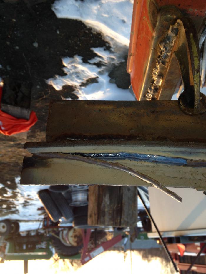

7024 is generally "self cleaning" or nearly so. You'll notice your bead wasn't dead straight and the slag still lifted for you.79jasper wrote:I was surprised to say the least.
Now tomorrow we'll see if I can do the same overhead. [CONFOUNDED FACE]
Also the "2" in 7024 indicates flat and horizontal positions only - overhead likely won't be easy with a rod not designed for it
Keep at it and have fun
Ah, disregard then79jasper wrote:The overhead will be 7018. [WINKING FACE]

Watch that video and just remember to keep lifting your arms - feels unnatural at first since you're pushing up instead of letting you arm drop.79jasper wrote:Just learning.
Good luck and cover your head and arms
If you do it right, 7018 slag should peel of great over head.
