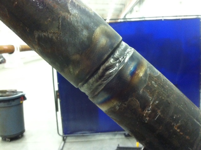

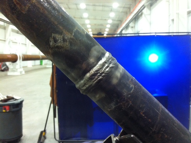

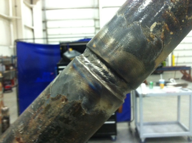

Here is another test I hebe been working on. It is 2" XXS SA106 in 6G welded to ASME 9 procedure. If I remember correctly, I ran two practice pieces and this is my first "real" test. I simulated the UA 21 test, 1/8" 6010 root up and 1/8" 7018 fill/cap up. I was a little more nervous on this one and really had to work on body positioning and manipulation to make all the transitions well. Again this will be used to establish our PQR/WPS so I have that butterfly in the stomach feeling. I am not as confident that this one will pass but we will see. There is a hint of undercut on both sides but I am sending it up anyway.
I was accused if "showing off" my skill or "bragging" here in what I have done. Those that know me know that is not the case. It is a little brag, which I feel we are ALL entitled to, but more a help for those who might be searching or help on any of these tests. Really, we don't get to see pics of years like this all the way through. I know I search high and low for any ounce if help I can get and the pics and specs I believe will help others out. I am getting over that don't want to show all my welds stage that sometimes we all have and am more willing to show real life welds. As Jody would say, I hope this helps someone if they are going for a test, that is my goal.
Again, pass or fail I will share the results and pictures.

Fill passes.
- image.jpg (84.71 KiB) Viewed 2578 times
- image.jpg (94.46 KiB) Viewed 2578 times
Cover passes and root

On a positive note, I received word that I passed this test as well!!! Should have the bends Friday.

That looks really good, congrats on passing. If you run into another situation like that where you have slight undercut and you can get away with it if you file that stuff out and wire wheel the crap out of it you will get rid of the undercut without being able to tell you filed on it.
They say the proof is in the pudding so here it is. This is a "pass" although you can see two spots of inclusions. Not to happy about that but not every weld is perfect.
