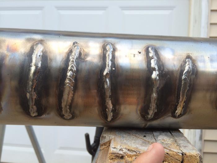

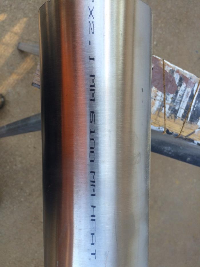

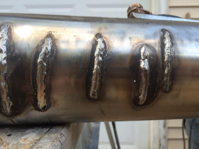

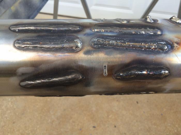

I started at about 30 amps and went up in aproximatly 5 amp at a time. Went vertical up and down. As well as horizontal at all possible angles on pipe. Except 6G. Found I started to get a better bead around 50-55 amps. Vertical up needed about 10 amps less to keep from burning through. 309 seemed to run hotter at the same amps. Need some more practice. Did both 309 and 316 theses are just some of the pics.
