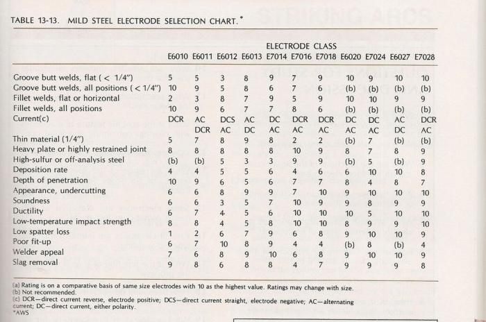

7014 is an excellent rod in place of 7018.
They are very easy to use and are basically a drag rod.
Here is a table from AWS with some of the comparisons.
- image.jpg (55.21 KiB) Viewed 3238 times

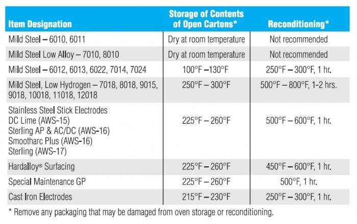

You can also recondition electrodes if they've been exposed to atmosphere.
- Electrode_storage_reconditioning.JPG (54.33 KiB) Viewed 3173 times
