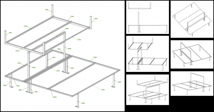

I have a van, and would like to build 2x beds and bike rack in the back to use for camping holidays / road trips etc. I have created a design of what i want, but am now undecided if I should build the frame from Steel or Aluminium.

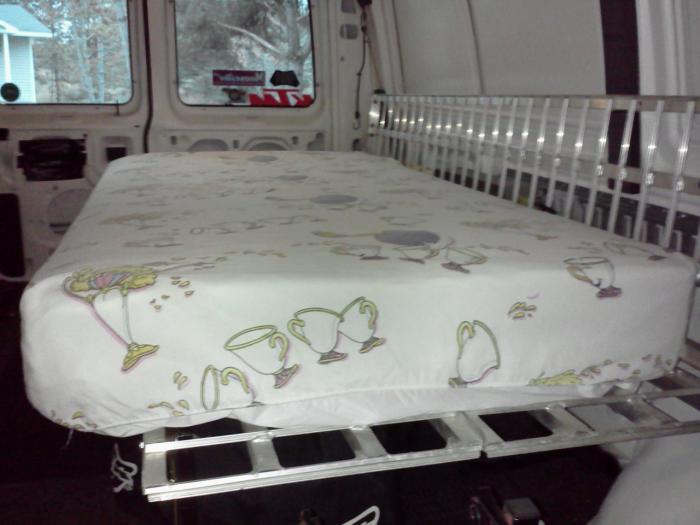

I had a van and a tri-fold aluminum ATV ramp just laying around. Made it into a fold up bed frame that when traveling was up against side of van wall with a single bed mattress leaned against it. I will try and post a picture. I used cables to suspend at side next to wall and a couple fold out legs to support when out at end away from wall. Just sat above wheel well, gave nice storage underneath when camping.

Thanks for the replies so far. @bruce - thanks, your bed looks great !!!!

Just fyi - this is the design I plan (would like) to build:
Van bunk bed and bike rack

I would be nervous as heck with the top frame. It looks like you only have one (1) supporting hoop. I would not think that would work. Better go with two (2) supporting hoops.
