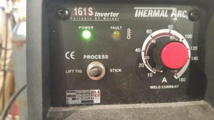

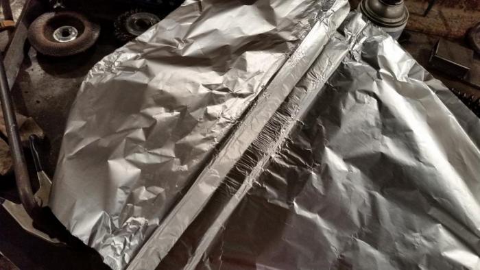

Here's some aluminum foil I welded at 10 amps DC- with a 3/32" tungsten
No light shined through when I checked, but it did have a tiny pinhole when I water tested it...
At 10 amps, when I first lit the tungsten on scrap the arc was just a buzzing large electrical field all over.
After the arc stabilized it didn't do that again and continued lighting up normally.
I had sharpened it on the belt sander, no polish - that's likely why.

@ MinnesotaDave - fusion welding aluminum foil is about about easy as it comes. Amps aren’t key, fixturing/fitup is crucial. Now, if you fused the surfaces via “open root” you’re a king.
Ron C shows his craft on 1thou Ally,
https://youtu.be/0p9s3DxMZ0A
Quite right, it's very easyArclight Ironworks wrote:@ MinnesotaDave - fusion welding aluminum foil is about about easy as it comes. Amps aren’t key, fixturing/fitup is crucial. Now, if you fused the surfaces via “open root” you’re a king.
Mostly I was just noting what happened with the 10 amps on my unpolished 3/32" tungsten.
I used two strips of stainless and sandwiched the foil with a little sticking out.
I went much slower than Ron C. because I wanted to watch the fusion take place.
I found it interesting
