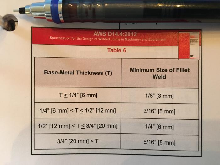

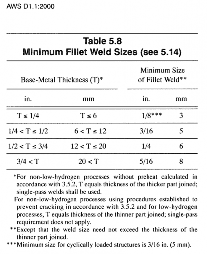

From a design perspective, all welds are assumed to fail in shear. The Minimum Size of Fillet Weld tables below are from AWS D1.1 (2000), AWS D1.1 (2010), and AWS D14.4 (2012). D1.1 is Structural Welding Code - Steel; D14.4 is Specification for the Design of Welded Joints in Machinery and Equipment.
AWS D1.1 (2000)
:: for base metal thickness of 1/2", a weld size of 3/16" is the minimum.

AWS D14.4 (2012)
<< Regardless of the above discussed minimums, your blueprint ultimately controls your weld size. 1/2" in your case. >>

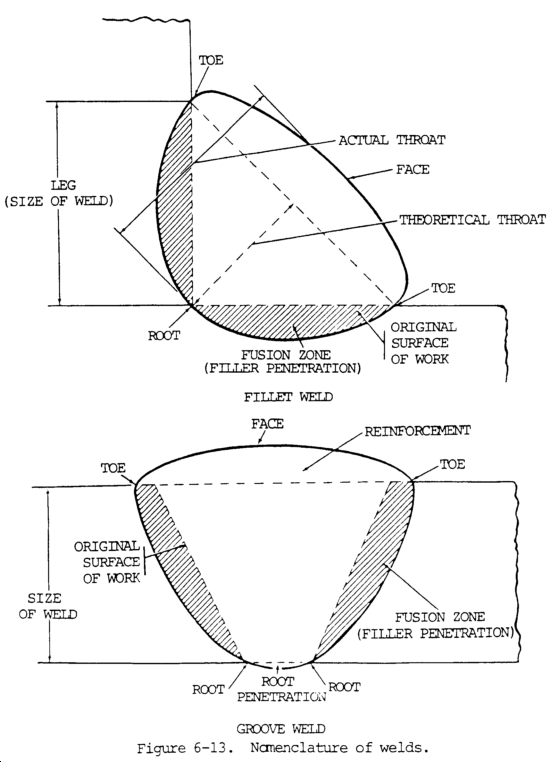

Background context for you regarding fillet weld sizing. Most commonly in blueprints, the 'size of the weld' is the leg length, not the throat dimension.
- fillet weld and groove diagram.gif (71.33 KiB) Viewed 6342 times
AWS D1.1 (2000)
- Screen Shot 2017-11-18 at 8.41.30 AM.png (355.68 KiB) Viewed 6342 times

AWS D14.4 (2012)
- IMG_8613.JPG (45.69 KiB) Viewed 6342 times

The Reinforcement, in the Fillet joint diagram, is the volume of material subtended by the dotted line (Toe to Toe) to the apex of the Face. None of that added filler material does anything to the strength of the weld. Similarly in the Groove joint diagram, the Reinforcement is the filler volume from the dotted line (Toe to Toe) to the apex of the Face. Again, no gain from fusing this added material to the weld Face.motox wrote:does "over alliance " refer to the leg or the throat or both?
AWS D1.1 specifies a maximum of 1/8in of "Reinforcement" for Groove welds.

Ok.. I think i got it. That chart shows a range of thicknesses and the min weld is within that range... Sounds almost tooo easy..
