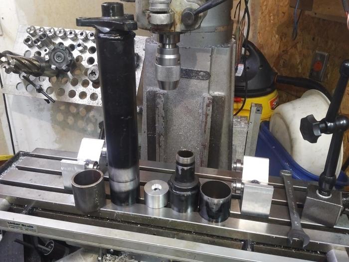

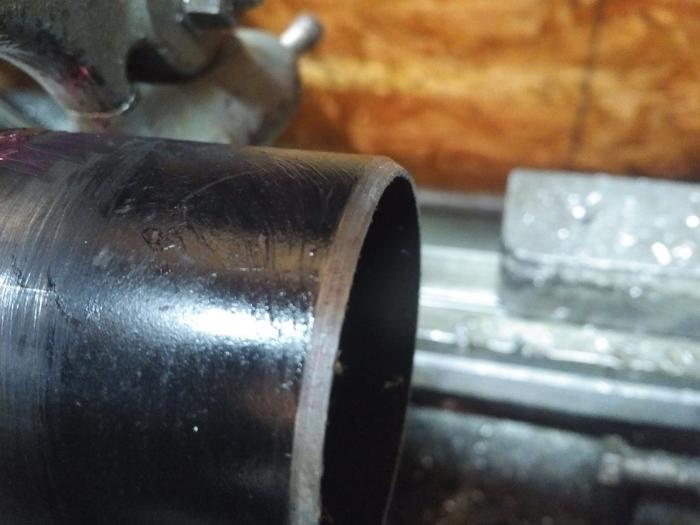

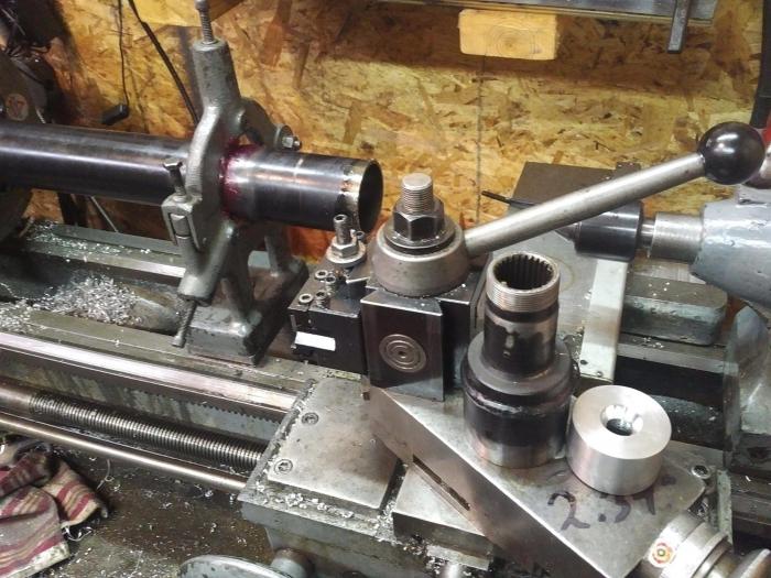

In the near future, I will be joining two 2.5" 095 wall mild tubes with a machined inner sleeve. I've requested it to be a tight hammer/press fit. The end result needs to be as straight as possible.
My plan right now is to fit it up straight, clamp some angle iron in each side, verifying that it's still wobble free. Then hit it with quick tacks on opposite sides, moving the clamps after cooling and continuing to do so around the perimeter, verifying that it's straight, and if it moves, hitting the tack on the "long" side with compressed air.
Then after I have an autogenous root, go over it with filler, with the pulser on about 50/50 in the positioner, maybe even less bg like 20-30, doing maybe a half inch at a time on opposite sides.
Any tips for success would be appreciated! I'm kind of hoping that the tight fitting sleeve and clamps will keep it straight but I've never done it this way before so I'm not sure what to expect.

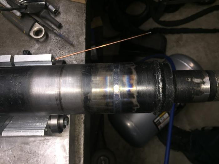

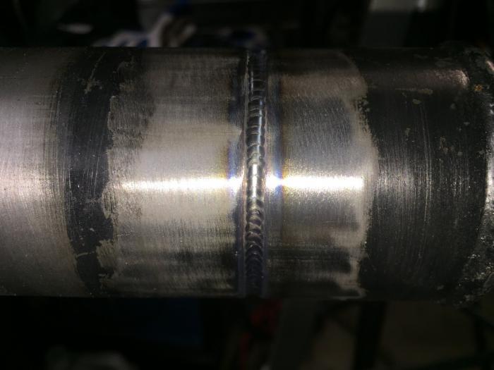

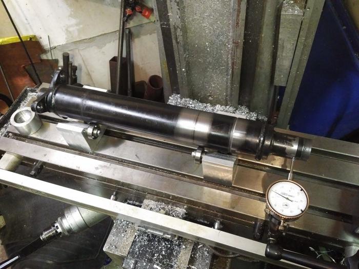

Turned out well! I still can't quite wrap my head around how much welds make metal move around. I know it does but I find it hard to "feel" like it's real. My friend machined it to such a press fit that he needed to use his mill table to assemble it. He adjusted it to a 0.002"ish runout and handed it over to me. I hit it with quick hot tacks every 120 degrees. Then did an autogenous root followed by a cover pass. It was up to almost 0.03" runout! I feared I'd need to cut it back apart, readjust and reweld but I went over with the pulser over the entire joint again and an extra pass where it was "long". Then hit it with compressed air as I checked it. Now it's back down to 0.0025" runout. I don't have a pic of the final weld but I'm very happy with it. It's barely above surface and the ripples are very tight and shallow (the final pass before the air gun was at a high pulse rate). I definitely penetrated to the sleeve so I think it's as good as I can make it.
