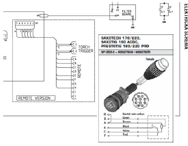

I am doing exactly the same modification, using the manual of the SAF-PRO Saxotig 160 ACDC. That is a very very similar machine which has the same controlling card and could be delivered with pedal.
Here below is a pic with the 7 pin connector (blue) in the middle, which is the inlet for the external control. On the picture you see a green wire which I used to verify that joining pins 3 and 7 activates a relay which changes from the front panel potentiometer to an external potentiometer. Unfortunately on this machine we need another potentiometer specific for limiting the pedal current, it cannot be done with the original one as it gets disconnected.
Here you see the schematics of the 7 pin connector on the circuit board and the connector of the torch.
- Pin 1 and Pin 2 are already wired on the front panel connector. To be connected to the two cables of the switch inside the pedal.
- Pin 3, Pin 4 and Pin 5 need to be connected to the 3 cables coming from the potentiomenter of the pedal. If your pedal has a limiting current pot, nothing else to do. If your pedal does not have limiter you will have to install it on the front panel of the machine if you want this option. The schematics are the same as shown some posts above.
- Pin 7 needs to be joined with pin 3 to activate the external control for the pedal. You can do this internally on the pedal side, so the machines changes automatically when you plug it. In my case, I prefer to install a small switch on the front panel to change manually. That way I can leave the pedal always plugged and decide when I want to use it.
We also need to wire the front panel connector, because Oerlikon decided to leave it unused
This is a pic of the same, were you will need to weld 3 cables and take them to the pins 3,4,5 on the circuit board.
