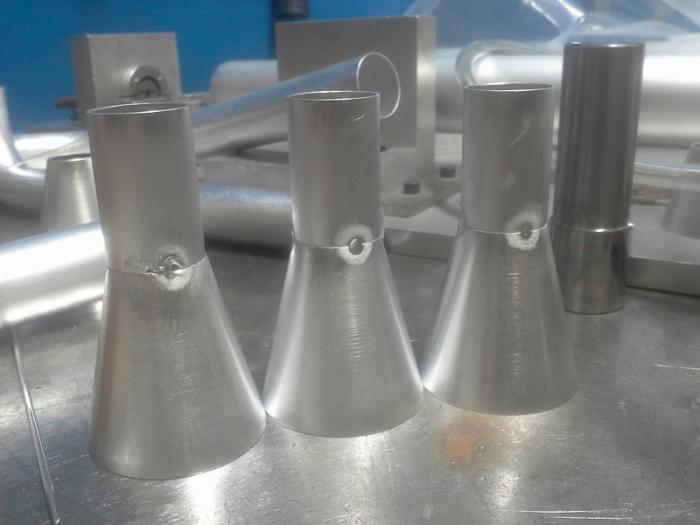

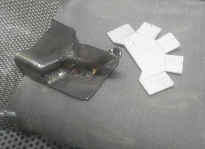

Here is some .025" I've welded. All of it purged
800 20140624_163137.jpg (33.37 KiB) Viewed 2813 times
800 20140716_185908.jpg (33.5 KiB) Viewed 2813 times
