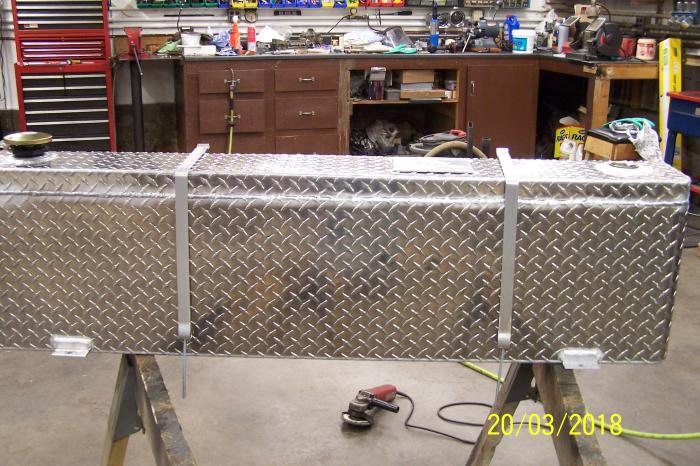

I put this tank in the bed of my truck, not realizing it was too tall to keep the toneau cover on.
So I want to cut it down about 3 inches.

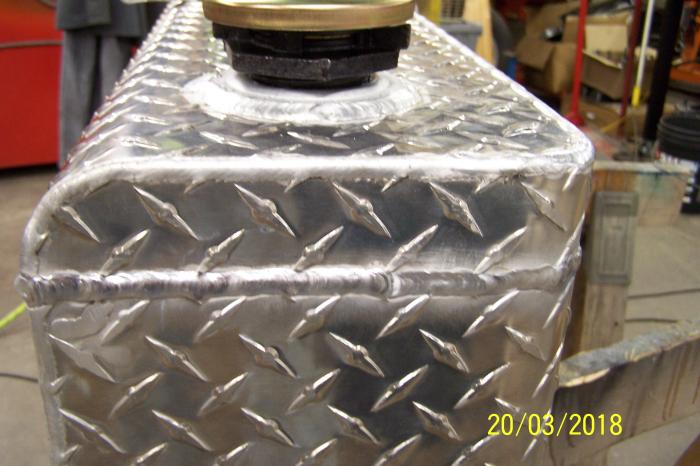

Tank is apart & cut to size. Since I'm not an expert alum. welder, would it be better to use a a strip 1" to 1 1/2" wide & do lap welds instead of a butt weld? Might be less prone to cracking too?
As far as the tabs for mounting, I don't have them bolted tight, but have a spring on the bolt to allow a bit of movement.

No BOOM, didn't come out too bad for first time welding aluminum. Made some straps for it, instead of the tabs being bolted to the box.

Looks really nice, you must have done a good job cutting it to get a nice tight joint. When you first posted I looked up Frostbite Falls, I thought you were being a wise guy. I never knew it was a real place but was one of my favorite imaginary places as a kid.

Tank looks great

Nice Job, especially for your first aluminum, I do like the straps!77cruiser wrote:No BOOM, didn't come out too bad for first time welding aluminum. Made some straps for it, instead of the tabs being bolted to the box.
