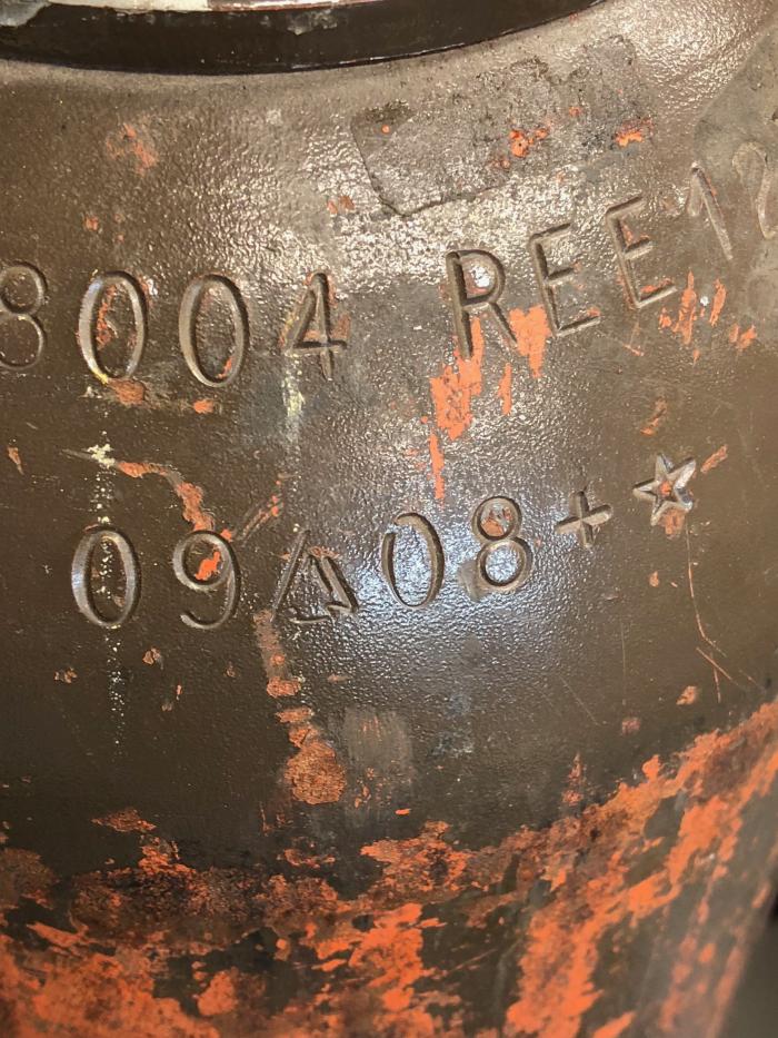

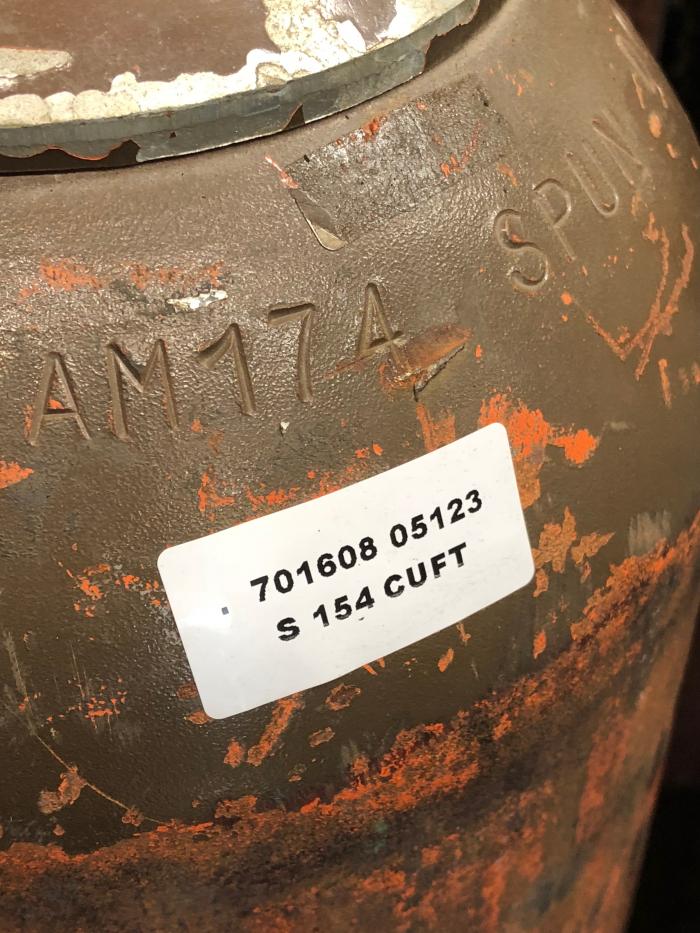

GAS - I ended up buying a full 100% Argon/ 154 CUFT customer owed bottle from a guy off of Craigslist for $150. He's an older gentleman who runs a muffler shop, and it's his side business to sell bottles. He threw a gauge on it to show it had 2,100psi, which he said was an indication that it was "full". Then he spent a long time giving me advise about bottles, refills, and welding in general. He said if any places give me trouble he'll have his guy swap it out. So that's a nice worse case scenario. I had called three of my LWS's and they all said they'd do refills on customer bottles this size. This particular bottle is about to expire (thus the price) and will need to be hydro-tested, which is fine. The LWS all say it'll be $30 to have that done.
