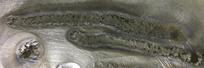

I upgraded my Eastwood TIG 200 AC/DC to the Digital version, as I wanted to have the nicer pedal as well as the ability to adjust the AC balance.
While welding steel works just fine, like with the old welder, I am not able to weld aluminum anymore.
I neither get a clear puddle, nor any cleaning action. Also, the filler rod is immediately getting a dull appearance and balls up.
This is what the beads, without added filler, look like:
At first I thought to have insufficient gas flow, but gradually increasing it to the point at which the gas would make a hissing noise, had no positive effect.
I started with the settings, recommended by Eastwood, but also tried to vary these values:

What is your amperage setting? Set your ac balance to 70.

What you don't mention is the thickness of the aluminum and the amount of amps you are using. It looks to me like you aren't getting hot enough and not breaking through the oxide layer. I am guessing a 1/16th tungsten is just too small for the metal you are trying to weld. Typically a 1/16th can only handle up to about 100 amps. If you are welding something thicker than say 10-12 gauge, you really need to step up to a 3/32 tungsten (or larger). As far as your settings go:
Tungsten: I would switch to a 3/32 at a minimum, maybe a 1/8th. I tend to use 1/8th on all my aluminum work. I prefer the 2% lanthanated, but that isn't likely to change your situation.
AC Hz: I would bring this down to 60-70 to start with. Lower hertz puts more energy/heat into the weld, I am guess you are just not getting the metal hot enough
AC Balance: This is the percentage of time the current is electrode positive. Too much electrode positive will ball the tungsten, not enough and you don't get any cleaning. I would start at 40% and then lower it down until you get just enough cleaning action
Make sure you don't have the pulse on, at least to start.
Just some thoughts for you to check out. Good luck.

Thank you for your responses.
The aluminum on the picture is 6061-T6, 0.025" thick. I think I ran the bead on the picture with 28 amps.
I however also tried thicker pieces of 6061-T6, but with the same result. I even increased amps to the point at which I pretty much immediately burned a hole through the material - still neither a clear puddle nor the white oxide around the bead, resulting from the cleaning action.

Is it just me ? or does the picture look like the machine is putting out DC ? being you have welded before on AC can you confirm audibly that the machine is outputting AC ? ( if you turn the frequency up & down you will hear this ) probably quite wrong here but all the comments on tungsten type etc don't seem to cover the route problem - sure any number of such things can make a weld look better or worse but this is fundamentally not welding at all so the problem would appear to be something else - other alternatives may be the material itself ? no chance it's anodized or something daft like it's not what you think it is ? is it worth trying on another piece of metal ?
I checked the gas flow again (I am using 100% Argon) and set it to 20 SCFH, to be on the safe side and can hear the gas flow. It appears as whether I have no leaks; I shut off the gas valve yesterday evening, this morning it still showed almost full pressure. I also covered the cup on the torch with my thumb and briefly pressed the pedal to initiate gas flow - it would hold the pressure inside the torch until I let it go after few seconds.
Here is a new sample on 0.100” aluminum, which I had first cleaned with a fresh flapper disk, then a dedicated stainless steel brush, followed by acetone. I used a purple (rare earth) 1/16” electrode, set the welder to the preconfigured aluminum program and adjusted the amps to 110. Still, very similar results, compared to the picture above with the 0.025” 6061-T6 aluminum. No evidence of any cleaning action and I could clearly see how the oxidation layer would just float on top of the molten aluminum. As shown on the picture, the piece of aluminum would melt away within a few seconds, without ever forming a shiny puddle:
I later again tried to vary the amps, the AC frequency and the AC balance, I however never came even close to a useful setting.
I upload an only few seconds long video to YouTube, audibly confirming that the welder actual changes to AC: https://www.youtube.com/watch?v=PUJAg-PQKyM
When I changed the frequency, I could also hear that the changes took effect.
The first picture I posted is aircraft 6061-T6 aluminum on which I ran beads with my old welder without a problem and clearly visible residue from the cleaning action.
The 0.100 piece of which I just posted a picture is a some scrap high quality 4027 aluminum, used by the guys in my employer's shop.
Also note, that welding steel in DC mode works just fine. This is a 0.060” thick sample I welded just this morning:
If there would be something wrong with the gas(flow), steel probably also wouldn't weld good!?
I actually think that there is a problem with the welder’s AC mode.

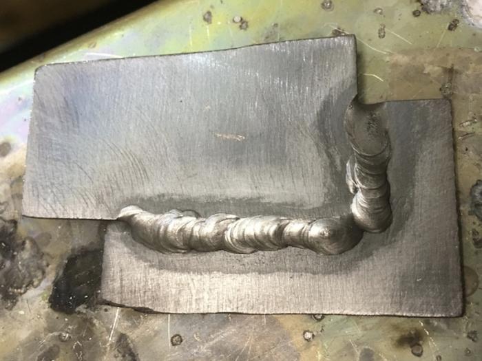

0.060” chromoly 4130, inside corner joint.
Except of some crap in the weld, I think that it looks acceptable:
The other side:
Absolutely no luck with aluminum, though. I guess they’ll have to swap the welder….

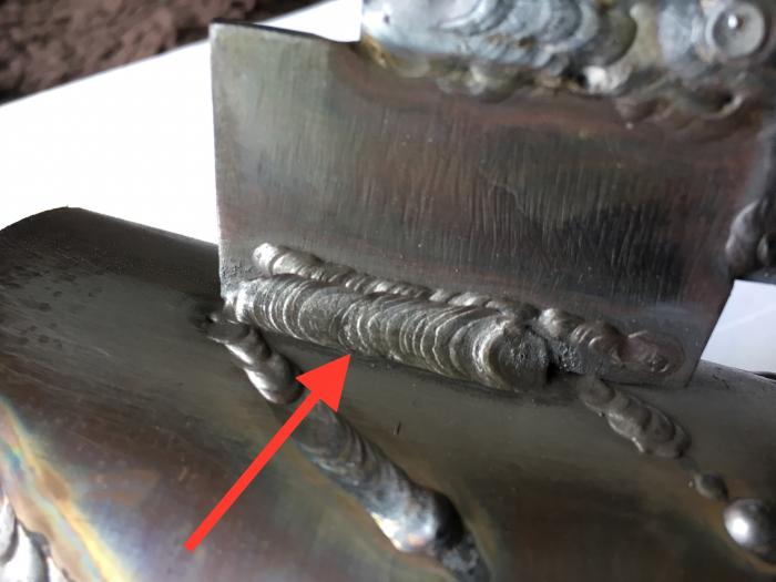

Eastwood sent me a brand new welder: I still had he same problem. Since the selector knob also had a tendency to stick, I however feel only a little bit bad about swapping it.
So, today I also emptied the gas cylinder and had it refilled - this did the trick! Check out the beads I ran today:
Now, I need to practice more. Thanks again for your help.

It was definitely the gas.cj737 wrote:So you think it was the machine or the gas? Did you run test beads with the new machine and the old gas? I don't think it was the gas since your DC beads looked perfectly good (like you new AC beads look!!!
After I received the replacement welder from Eastwood, I had the exact same issues as before. I started with their recommended settings but also tried a higher gas flow, higher / lower AC balance, current, etc.: Absolutely no luck. The filler rod would get dull before I even came close to the arc. I could also see the oxides just float on the molten aluminum, without any cleaning action.
I then had the gas tank emptied and the shop filled and drained some Argon, before the finally filled it completely.
Back home, I let the gas flow for a minute or so, to get all the old gas out – after that, the problems were immediately gone, even though I had changed absolutely nothing, besides of the tank, compared to the day before. I even still had the same electrode and continued to use the same sample piece.
I found a thread in another forum, in which a guy posted very similar pictures to mine. It turned out, that they did not purge the new tank, before they filled it with Argon. Apparently, the residual air in the tank caused the problems, he had.
I suspect that this is also what happened with my tank, as I had it bought just before I upgraded the welder.
