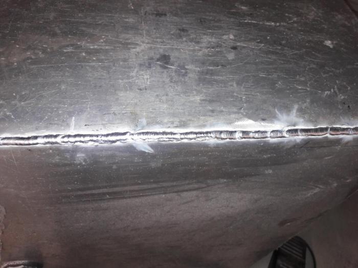

well the day came far earlier than expected.
the boys came back with a big leak, but it was a new leak. an entire corner had cracked open.
so now there is 3 leaks to fix.
big one first.
cracked corner
cracked corner
you can see the sort of welding i'm up against ! and thats some of the better welding on this tank.
so tonights effort was to grind that off and reweld it.
i ground it a little to much and ended up with a bigger gap than i wanted. then i had no end of trouble getting 5356 to flow.
ended up starting to blow holes. switched to 4043 and that went fairly nice.
then capped it with 5356. not sure how the two fillers react with each other.
a few moments of teaching the tungsten to swim as you can see.
fixed
fixed
would have really liked to use the tig finger and stubby gas lens on this but they are in transit. that tank was getting fairly warm to have my hand on.
had to use my stick welding glove to rest on.
the other leaks is tomorrows job.

What settings were you using on your machine to weld that with? I ask because your cap weld looks a bit "roped up" and not wetted in. Outside edges are a real challenge with aluminum to get right.
One trick you might try, is to lay/clamp some flat stock just outside the weld are, parallel to the corner joint. This will act a bit like an argon dam, and help you trap that gas and get things really cooked in. Even if you tack some ally flat bar that you later knock off and flap disk the tacks. Some 1/4"x2" stock works great. It also can help prevent heat soak on thin sheet as you roll along, buying you some time with the arc before burn-through.
I find it interesting that others have difficulty with 5356, or it cracking. I find that to be true with 4043, but never have I had that issue with 5356. I do also use 4943 instead of 4043 for the same reason. I do wash the weld with post flow to aide in cooling it though, so perhaps that's the difference?

pedal set at 140 amp max. last bead was foot to the floor for most of it.
frequency is fixed, no idea what it is. balance is somewhere around 70% en (dial isn't really marked).
the original welds where not done my me. that was someone else using a mig. no idea what spec filler they used.
