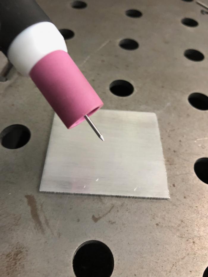

It would be helpful to see a picture of the welds you're getting along with the actual settings on your machine for those welds. Balance setting, Frequency, Amps, material thickness, cup size and tungsten size/color. If you even shot a picture of your machine's front that too will help in case you have something backwards.
Well this are my typical results.
- This is what I get
- IMG_1239.jpg (66.58 KiB) Viewed 4027 times
- HTP Settings
- IMG_1238.jpg (78.49 KiB) Viewed 4027 times
- New Tungsten and cleaned with Wire brush and Acetone
- IMG_1237.jpg (46.92 KiB) Viewed 4027 times
70 amps is probably too low for that material, bump up to 120.
The second picture showing your tungsten, shows a fairly long stick out. You can move the tungsten back in a bit, probably half that exposure.
The balling on your tungsten shows a fairly low BALANCE setting. Please confirm the color of your tungsten, and what BALANCE setting you are using.
The first picture shows poor gas coverage, and/or too long an arc (the distance your tungsten is from the work pice). Try to maintain the tip of your tungsten equally far as the diameter of your filler. Really. You may have to arrange the work piece so your eyes can see, or go up a few sizes in your cup. Also, a good quality gas lens helps enormously.

One Question, is your ac light blinking or solid? if its blinking you are in amplitude setting and that's why you are having problems. if not CJ is right use his settings to start.
Your tungsten is blue as hell... not enough gas coverage, your stick out shouldn't be more that the width of your cup opening. if your cup for instance is a 8 the opening is a 1/2" your sickout cant be more than a half inch. Then you take your gas and times it by 2 so a 8 cup with be 16cfh roughly. Thats how how you measure stick out and gas coverage.
Also the HTP invertig 221 likes new metal at 65% Balance you can run freq anywhere from 60hz -200hrz that just changes your puddle size it wont help you go from your weld to a good weld only the AC balance will. You are having coverage issues, get that sickout like i said. again a 8cup is 1/2" every cup or or down is a 1/16 difference up and down.
Most definitely keep the tungsten stickout to 3/16" there abouts, and hold the torch vertical so you can assess the situation first. You absolutely must get a clear, shiny, mirror-like puddle with little to no black pepper in the frosty region before you can go any further. 3/16"-1/8" arc length maximum. Also, don't baby the pedal. You need to drop the hammer since aluminum conducts heat so fast. That's one thing that is hardly ever shown in videos, it's part of the technique.

Yesterday I installed a fresh tank of Argon gas and noticed that the flow meter was not reacting as it should. There is stuff inside on the tube on the ball.
Hopefully this is my problem. Not even trying to fix this flow meter, I bought a regulator on ebay that seems more accurate to me. Will try this again when the regulator comes in.
