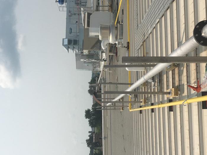

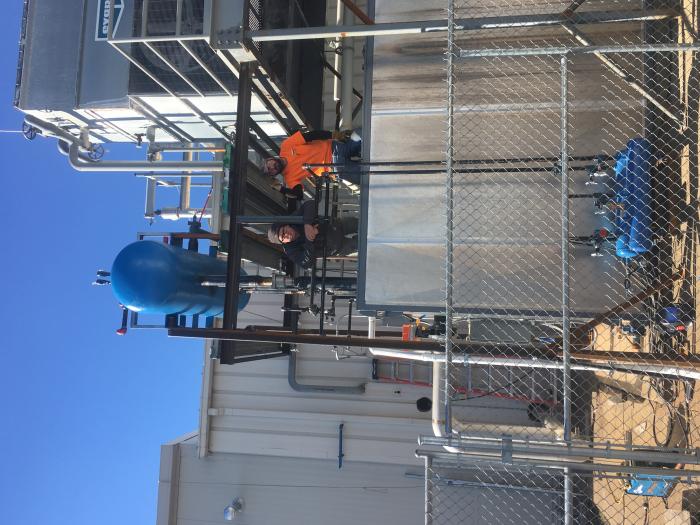

Some of the stuff I’ve been working on lately
New ice builder at a small food plant.
About 300 ft of 4inch sch 10 SS steam main. All purged because it will be used on food. These were before it got insulated. The big Evapco in the distance was part of what we are adding as well.

Nice job Josh!
Staino is tidy and clean.
Ammonia pipes are, well, ammonia pipes but outside under that beautiful blue sky, I love that work. I notice the spaghetti is all done with socket weld, is that common practice over there?
Cheers,
Vic.
Depending on the job. There’s a few 3/4 inch butt welds. Because of the ease and speed of sockets usually 1- 1/2inch and under.
Coldman
    Mon Dec 15, 2014 2:16 am
    Oz
Makes perfect sense to me I don’t know why we don’t do it here on ammonia work. Only time we see it is on assemblies out of the usa or on steam work. Getting harder to find the fittings too.

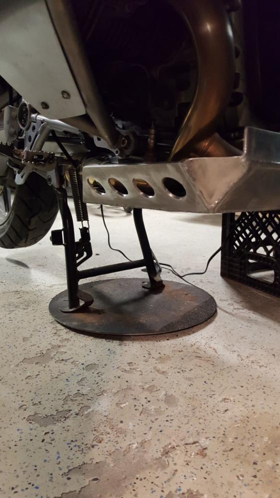

Aluminum skid plate for the BMW
Finished and ready to the final buff.jpg (46.48 KiB) Viewed 6109 times
I made this a few weeks ago out of aluminum 5056 3/16 thick and it has served me well to protect the underside of the adventure bike.

Plans for any drain holes? Or punched holes to strengthen it?

No drain holes but I did add four 1 3/4 holes on each of the sides for air flow. It has easy to remove countersunk fasteners for getting off for oil changes.

Installed and ready to rock
Mounted up and ready to ride.jpg (45.99 KiB) Viewed 6274 times
bruce991
    Tue Jan 05, 2016 10:31 pm
    Central Michigan
Added ventilation holes
Completed with holes.jpg (73.07 KiB) Viewed 6275 times
    Sun Nov 19, 2017 10:09 am
Those holes made it look like it was commercially made! Good job.

bruce991 wrote:Added ventilation holes
You did a nice job constructing that.
I'm giggling a bit, exhaust systems don't need "ventilation" holes. In fact, the more protected they are from cooling air flow, the better they work. When you look at the manufactured systems of these skid plates, the holes are punched for strength, not ventilation. Because ally is pretty weak, having those punched holes increases it strength tremendously. And you do get some debris/moisture draining advantages, especially on an Adventure bike.
Exhausts that remain protected from cooling forces scavenge the exhaust gases better, and increase the gas flow rate. This is advantageous primarily along the header and until it passes the CAT, where most condensation starts, and rot attacks. Remember that hot air moves toward cold surfaces. So the gas internally is drawn to the perimeter of the pipe, then loses its energy (heat) as it is cooled, slowing down the flow and lessening the scavenging of the gases. You'll see folks wrap exhausts in pipe wrap which as an insulator is a good idea, except that this wrap (on bikes) is a terrible idea as the carbon steel pipes below rot prematurely due to moisture being trapped against the pipe. A ceramic coating inside is the best treatment, and outside for ambient temperature (your body's proximity) comfort. If the exhaust is stainless, the rot is less an issue, but the internal treatment still is a major advantage from effectiveness of scavenging.
(This was entirely for informational purposes, not criticism, so please accept it as such.)
tweake
    Mon Dec 18, 2017 4:53 am
    New Zealand
I'm giggling a bit, exhaust systems don't need "ventilation" holes. In fact, the more protected they are from cooling air flow, the better they work. ............... You'll see folks wrap exhausts in pipe wrap which as an insulator is a good idea, except that this wrap (on bikes) is a terrible idea as the carbon steel pipes below rot prematurely due to moisture being trapped against the pipe. A ceramic coating inside is the best treatment, ........
not quite right.
its not rust that kills wrapped headers/pipes. its overheating the metal that does it. with the insulation on the outside the metal can't cool, it overheats and degrades.
however ceramic coating on the inside works great because the insulation is on the inside which keeps the pipes cool.
a bash plate doesn't need vent holes. theres tons of air flow around to keep the pipe cool. most cars have heat shields on exhaust parts (ie manifolds) and they generally have no vent holes.
not sure about cutting holes to add strength. you can get strength from holes if the edge is bent in. often use a die to press it in.
cj737
    Thu Sep 29, 2016 8:59 am
tweake wrote:
Hey Tweake, I didn't advise cutting holes I suggested punching holes as cut holes don't increase the strength where punching can. And we agree on the lack of venting, but I suggested drain holes in the bottom/punched holes serving the same purpose. An Adventure bike is prone to wet and dirty rides, and a flat tray beneath the motor is a strong candidate for collecting riding schmootz that needs to be evacuated.
