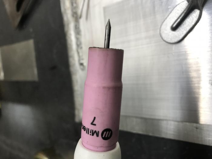

I'm trying to teach myself how to TIG weld aluminum. I've watched the WT&T and ChuckE2009 videos half a dozen times (each) but I just can't seem to get a decent puddle to form.
Here's my setup:
Miller Multimatic 220
3/32" grey tungsten (2% ceriated)
3/32" filler rod
1/8" aluminum
100% argon set to 15 CFH (I've tried as high as 22 CFH)
#7 cup
I'm using the auto-set features of the MM220 which for this combination says 135 amps (I have a foot pedal). I'm cleaning my material with a wire brush and then acetone. I've attached a picture of my ground tungsten in the torch.
When I fire up I try and ease into the amps (I don't just full mash). I see the frosty cleaning action start but I never get a good puddle. If I go full pedal I get a gummy mess of a pool that has some sort of film around it but it never flows - it just clumps. If I try and add filler rod it doesn't melt off but instead breaks off or starts to melt then sticks back onto itself.
Your guidance as to where I'm going wrong and what I need to work on is greatly appreciated.

First, that’s a standard collet body and cup. Drop to a #5 cup and shorten your stick out. 10cfh. I set my machine to 170 amps for that material thickness. Aluminum takes more amps than steel to get a puddle, but once you get going you can back off the amps as aluminum keeps the heat.
An aluminum puddle is very different than steel, so get accustomed to seeing a difference. Bump your amps to 150, mash it, then taper off as you go. Don’t add filler until you’ve got a wet puddle. Keep your torch pretty upright too.

I suggest that you cut the Tungsten stickout to about half of what you show in the photo. That will improve your gas coverage.
From your descriptions, it sounds like there is still a lot of oxide on the base metal. On fresh clean aluminum, a quick hit with SS brush will clean up a thin layer of oxide good enough to weld. On old dull aluminum with a heavy layer of oxide, you can wear out a new brush, and still not be clean enough to weld well.
I would try something a bit more agressive, like a sanding pad. You want the base material to have a bright shine before you wipe it with the Acetone. It is more critical when you are learning.

Thanks again for the info. It would seem that my biggest problem right now is material cleanliness. I took a flap disc to the aluminum and that has made a world of difference. Apparently, though, my filler rod is filthy. I can see globs of yuck entering the pool when I dab. Lesson learned - Blue Demon rods are gross. Fortunately I only have what little came in a starter kit when I purchased the welder.
Mashing and tapering off (instead of ramping up) has also helped quite a bit. I haven't yet swapped cups yet but I did shorten my stick out by about half.

Often times, your actual arc length causes some of what you are describing. Skip the flap discs, they embed crap more than they remove it. A good scrub with your stainless brush followed by an acetone wipe of the material and the filler is adequate.
Regarding your cup... Any time I use larger than a #5, I switch to a gas lens. It provides better coverage and shielding. Its not needed on the smaller cups (<5) as the orifice of the cup is so tight, you aren't welding an area that benefits from the extra coverage. And with a smaller cup, you can get better penetration with the same amount of amps.

ceriated tungsten is not great for aluminum, i see its recommended for low amps. 2% lanthaned is a good all rounder.
cleaning flap disk can simply smear the oxide into the aluminum. however imho it can work well if done at low speed (variable speed grinder). most of the time brushing with stainless wire brush in one direction works well.
just remember to clean up all dust, shavings etc. it has a real nasty habit of being sucked into your tungsten.
I think you're on the right track now. Nothing wrong with those rods, they're just oxidized. Aluminum begins to skin over with oxidiation about 10 minutes after it's cleaned to bright white. Just clean them up with a scotch brite and then wipe them down with acetone.jaso wrote:Thanks again for the info. It would seem that my biggest problem right now is material cleanliness. I took a flap disc to the aluminum and that has made a world of difference. Apparently, though, my filler rod is filthy. I can see globs of yuck entering the pool when I dab. Lesson learned - Blue Demon rods are gross. Fortunately I only have what little came in a starter kit when I purchased the welder.

Hey - can I suggest that you "blunt" your tungsten a little. From my experience a sharp grind like that is good for steel, stainless, etc. When I get to aluminum I make the tungsten quite blunt and it seems to help me direct the heat better. I think cj737 suggested this and it worked for me.
