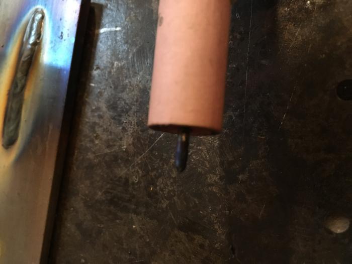

New to Tig Welding, I am a hobbiest and I've used and "mastered" other processes. I got some pictures here and was wondering if I can get some little tips.
Welcome Juliano
The dark tungsten, you need more post flow time
Tell us what machine you have, and your settings

add to the above,
what are you welding?
is it cleaned?
what gas are you running?
thats some funking looking marking around the welds.

I got an eastwood tig 200, I have a 75% co2 argon mix @ 15 cfh and running with a 3/32 tungsten set at 110 amps. The steel is 3/16" and it wasn't cleaned before use. I know that it should be cleaned with a wire brush but I was too lazy to pull out the grinder :roll: . However I don't dip the tungsten in the weld pool and it still has trouble keeping a pointy tip.

forgot to mention, running 0.1s pre flow and 4seconds post flow

Juliano_R wrote:, I have a 75% co2 argon mix
thats why its all funky and probably why the electrode is looking bad.
you need 100% argon.

I though you needed 100% argon just for aluminium

Juliano_R wrote:I though you needed 100% argon just for aluminium
with tig you need argon for everything.
with mig you need argon for aluminium.
thats one reason i prefer tig. you can use one gas with everything.
with mig you need to change the gas for each material and even material size.
