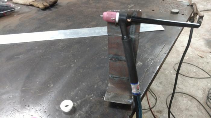

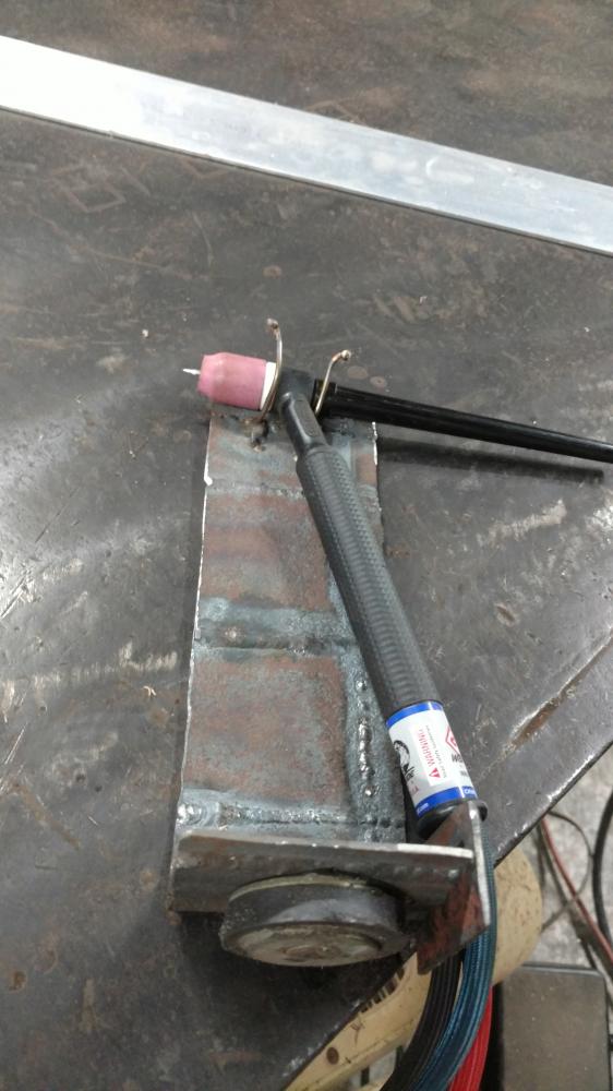

I made this one out of practice scrap and immediate necessity when I first started. The arms are silicon bronze practice and the magnet shows off my j.b. welding skills
. It is so comfortable to use that the torch nearly holsters itself. It clamps onto the aluminum table as well.

It is a standard large lens and nozzle is a #15. Try these part numbers for the 2 series torches: 45V64S and 53N89. There should be similar parts for the 3 series.LtBadd wrote:Functional and free, can't beat that. Which gas lens is that
