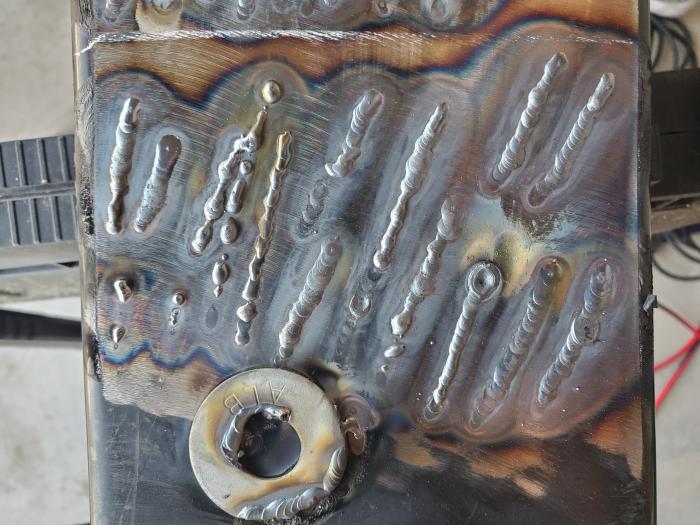

Thanks again guys. I'm playing more and more with it when I have time. I'm trying different positions and hands. I'm actually thinking I have way more control with the tig so i might try to go that route in the end. Here are some more I did tonight. Just playing with speed, flow, filler.... ignore the bottom one.

TIG does give you good control, once you get the dexterity and muscle memory down, and once you get used to spending 3x as long to weld something because you have to get it surgically clean. Stick welding gives you more "punch" for the amperage however, and you can get it down a heck of a lot faster with a rod like a 3/32" E6011 on 50-70A. It will punch through almost any surface contaminants with it's digging, forceful, almost violent arc.
