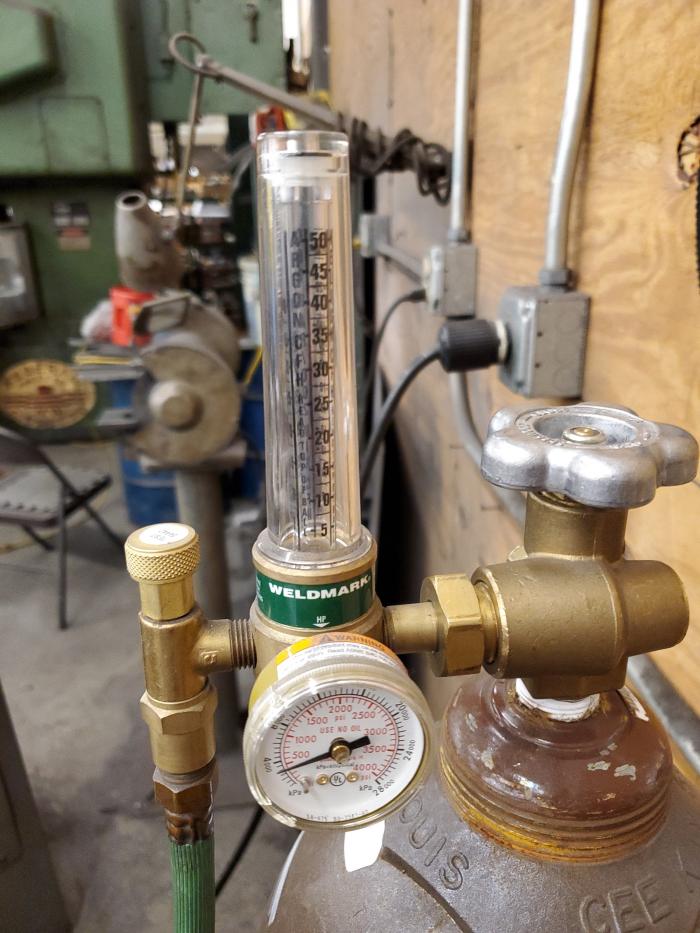

Very curious to see which flowmeter/regulator you are using, thanks. (ppsst: if you are using an argon regulator, and the ballfloat/dial is showing 10CFH, it's actually flowing 32 CFH of He)

My reg is calibrated for helium but your right oscar, i was looking at the argon scale O.o

Heres my reg Oscar, I thought I had the helium scale in the pic, Ill go get another. Flowing 10 cfh of helium on this thing is just about the minimum it can flow and very touchy at that low flow rate. Actually Im sure you dont need to see it, the scale starts at 20

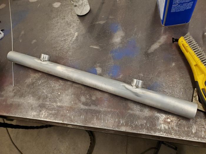

Well anyways I am going to do a batch of manifolds, these come in this way with the bungs tack welded in place. Not sure why they put such a huge bevel on it but I am going to see if they can omit it since they make these in house. These manifolds always have a ton of leaks and I am sure its also due to the lack of cleaning and poor machine set up.
Anyway its gonna take a ton of practice to make these look good, thoughts on torch path? Probably going to do it in 4 segments and see how it goes.

i would also get them to do a small good tack. ie get a welder to do the tacking.SMFRyan wrote: Well anyways I am going to do a batch of manifolds, these come in this way with the bungs tack welded in place. Not sure why they put such a huge bevel on it but I am going to see if they can omit it since they make these in house.
your going to have tack that in place and grind that hunk of snot off it.
as you mentioned already, the prep work is so important and is 90% of the job.
i would be inclined to grab their jig and do all the prep work.
Yeah its pretty bad, i took the torch and tried to melt it down and blend them in but theres so many of these, i think it will take too much time to do that to all of them.
So in the future i will make a jig to eliminate tacking and lose the bevel.

Ryan, looking good. I'm thinking the customer is using the bevel to locate the bung. The tack is ... well ... it is. I don't know if the customer needs a certain angle for the bung and that is how they are locating it...check with them. I also think that the bevel is playing with your eyes but you WILL get it done. Wish I were closer, I could feel a road trip. All the best .. Bill
That looks like a thread o let fitting. The bevel comes standard like that to allow for use of the same olet to be welded to different diameter of pipe. Example would be that if you were welding that same olet on a 12 inch diameter pipe. There would be less bevel exposed due to the different outer radius. If you want less bevel exposed then you need to grind it off before you tack it.
