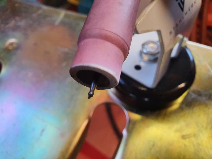

I am a beginner at welding. I have managed some ok welds in steel but cannot even get started with aluminium.

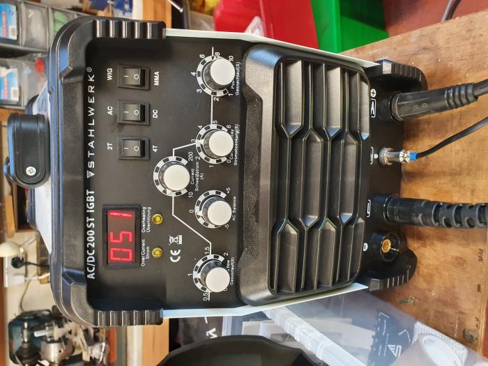

I have a basic AC/DC 200ST IGBT made by Stahlwerk
I cannot manage to strike a stable arc and get a weld pool.
I have a 2.4mm 2% Ceriated Tungsten (grey)
I have tried current ranging from 34A to 100A
I have tried balance set to zero = 70 - 30 and also at the extremes +5 & -5.
Filler is 2.4mm 4036
Argon gas at 8 l/m
Size 7 cup

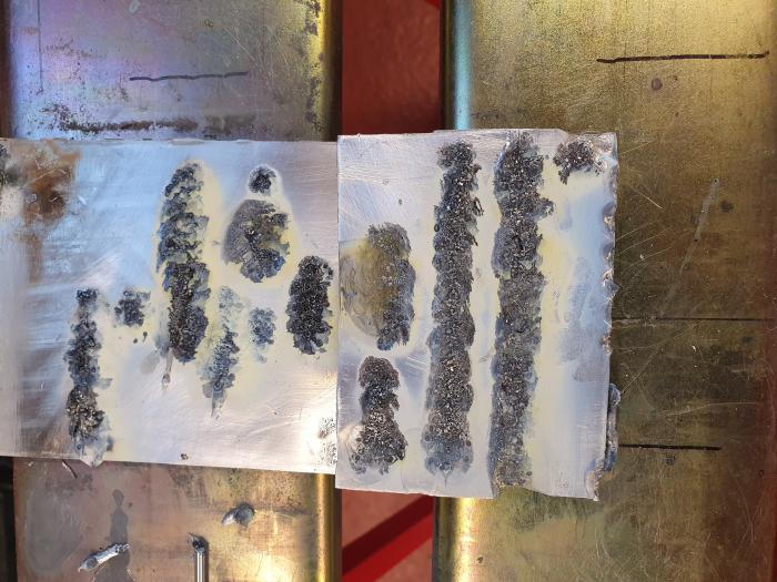

Results look like this. What am I doing wrong?
Electrode starts like this
Finishes like this
Machine

From the pictures it looks like you may have a gas issue.

I agree... with the gas issue... that looks like a #6 cup... I would double your gas see if that helps.

Your tungsten is sharpened too sharp. Try a blunt 60°included angle, with a flat on the tip.

You need to find out which "way" your AC balance is calibrated. Is more on the dial more EN, or is it more EP? Once you do do find this out, you need to set it to about 65-75% EN, or equivalently 25-35% EP.

In a similar vein to Oscar's point about AC balance, make sure your torch is connected to the negative plug. I point this out, because, well, I've done it the other way :oops:

Bernard wrote: Argon gas at 8 l/m
Size 7 cup
not enough gas flow. try about 15l/min.
use a blunt grind on tungsten, think crayon.
reduce stick out a bit.

I don't see a foot pedal that comes with the machine, so, I'm assuming that the machine is triggered by the torch switch. Set at 2T you will have on at full amperage setting and off at release of the switch. In your pictures, it appears that the material is cut with a hand shear so won't be too aweful thick. If the torch is connected properly, (to the port that has ARGON gas flow) and the work clamp connected to the + you will control ac and dc at the switch marked so. Since you stated that you have made some decent welds on steel, you were set at dc. Welding aluminum you want to be on ac and keep the tungsten close to the material with a slight tilt of the torch as if you were going to push the puddle that is formed. You are looking for a shiny puddle and it will probably come about quickly. I'm not sure which direction you want the balance set on your particular machine. Try it at 9 o'clock position and if that causes the tungsten to ball in a hurry go to 3 o'clock . I tried to watch a video of that machine but couldn't understand the demonstrator. :?

Thank you for the advice. There is no foot pedal with the device. The material is 2 mm thick. I am melting the material right through. I have tried 15 l/m and a 6 cup. The result is better but still not like any of the videos I have seen.
I definitely have the torch and earth cable the correct way round. The machine manual says that with the balance set to zero I should have 70% negative and 30% positive. If I turn plus I should get more positive and obviously if I go minus I get more negative but the manual does not specify by how much.

Hi, guessing you have the problem sorted by now but just thought I’d put my 5 cents in. Looking at the photo, is the torch connected to the correct port? I just wondered if where you have it connected is for mma stick welding and that maybe the torch should be connected to the - port next to it? I do most of my aluminium welding with a 5 cup and the argon set at about 12l/m and seems to work fine for me. Advice I remember from Jodys videos, clean, clean, clean wipe your rods and the aluminium edges you’re going to weld with acetone or similar as this makes quite a difference to your weld pool.
