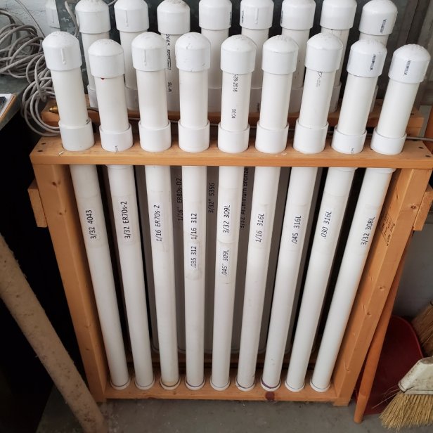

speaking of storage...
Is it worthwhile to incorporate desiccant packets in the rod storage tubes?

DougW wrote:speaking of storage...
It can't hurt. If you weld in a garage with no AC or heat, try to keep your steel filler in the house. Also try to only buy as much as you expect to use in 6-12 months max. The steel fillers can and will corrode if improperly stored for long periods. Same for MIG wire.

My garage has a window AC unit that I only use when I work, I've had steel filler for a few years without problem but it is stored in PVC tubing. I'm in Florida so humidity is high, still the desiccants packs could be useful.
DougW
    Tue May 12, 2020 7:45 pm
I have a similar, though less extensive, set-up. You went vertical... I went horizontal...

DougW wrote:I have a similar, though less extensive, set-up. You went vertical... I went horizontal...
Image20200623_115527 by Doug Wei, on Flickr
looks good to me, you're all set

My filler is color-coded by type, stored against the elements.

What's the common sizes used in these PVC storage tubes? Obviously I can buy what fits, just asking if a certain size works better. I need to get started on a storage rack.
    Thu Dec 26, 2013 12:41 am
    Laredo, Tx
the 1½" PVC holds 10lbs worth of steel or nickel based rods perfectly. For Aluminum the 3" PVC is better if you buy a 10lb box. Perhaps 2½", but I'm pretty sure its 3".
DougW
I just made mine and I used 3" on the aluminum and 1 1/2" for mild steel. I have yet to purchase any stainless rods.
You "might" could get by with 2 1/2" on 10#s but I think it'd be very close.
