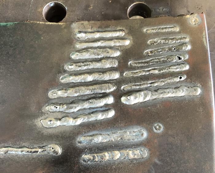

New member... Been following for a bit and have watched probably every video there is on TIG. Been a hobby welder for 20 years (MIG carbon and AL) and recently retired from my grown-up job and now work at a country machine/welding shop (job shop) where I've helped at off and on for the last 15 years.
We wanted to add the TIG procedure to our capabilities.
Holy Crap this TIG thing has a lot of stuff going on at the same time. I just received my CK Worldwide MT200 machine and got it all set up and ran a few beads without filler on 11ga carbon steel then attempted to coordinate the addition of some ER70s-2 filler while running a pedal, maintaining torch angle, arc height, travel speed... Whew!!!
Looking forward to this coming together. Makes me envious of ya'll that can make sound, good looking TIG welds.
Attached image is of my first runs. This is on 11ga scrap I ran a wire brush over. 120 amps, 3/32 electrode, #5 cup, 12 cfh Argon. Upper right started with no filler, just push'n the puddle. Left column I added filler. Didnt take a picture of the back but It burned through a bunch. I'm guessing i'm way-to-slow right now.
Thanks for viewing. And any advise on drills to get up to speed is appreciated.

Welcome. You are losing gas coverage as evidenced by the pin-holes. With such a small diameter cup, you have to keep a short stickout, I recommend 1/8 - 3/16", and keep it consistently at that height. Also, a lot of beginner's use 30-45° push angle, and that is another avenue of lost shielding gas coverage. 15-20° max. Other than that, not bad at all. Don't lean on your forearms and put excessive weight on them because then you won't be able to make smooth, non-jerky movements. Tighten up your core, take deep breaths to stabilize your movements, and only lightly rest your arms/hands on what ever supports you are using. Never "free arm" the TIG torch during the learning process.

Try going up a bit in cup size while you are learning. I'd suggest a #7 or #8 for the welding you are doing there, while you are in practice-mode. You can learn to save on gas later. A #5 cup is fine, but there is no sense in making it harder on yourself while trying to dial in the basics.

Uh, Keith, you must clean the metal you are welding to a bright, shiny, almost surgical level when TIG welding. The #5 cup is not your issue, mill scale and crap on the surface is causing the porosity.
If you look closely, there's a consistent gas coverage shadow around all your welds, but I suspect that your tungsten has a fair bit of Schmutz on it from welding without cleaning.
You can flap disk it, but then wipe it with Acetone. You can use Brake Kleenexes, but use the non-chlorinated type only (you probably know this.) For TIG to succeed, cleanliness is everything.
