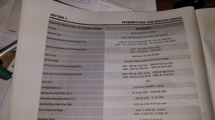

I finally got time to take my 255EXT apart to see what I could do about the unstable arc on AC. One of the first things that I noticed, was the Gap Points for the HF start. Considering that one of the reasons I bought this welder, was it had 'Solid State HF' , I feel a bit 'ripped off'. Just to make sure, I double checked the manual that came with my welder.
Slight change of plans. 'Clean and check the gap' was added to the list of things to do. As was trying to locate a spec for what the 'Gapless Solid State HF system' should be gapped at. Given my previous lack of help from NEVERLAST support, I didn't waste my time calling them. Mark LugNut would probable try telling me that those points had nothing to do with HF. Sure, Mark, Sure. NOT!
It's like buying a new car with a window sticker saying it has a V8 engine, then finding out it is really a straight 6. The V8 they was talking about, was a can of vegetable juice they put in the trunk!

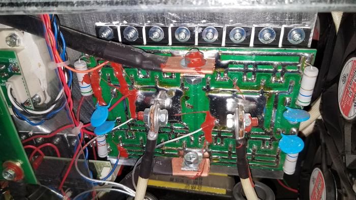

I have never seen a quality electronics company leave heavy flux on a circuit board like this. Even Rosin flux will eventually lead to corrosion. I spent an hour with 99.9% IPA, and a bunch of Q-Tips, to remove the flux, embedded trash, and a bunch of solder balls. These are basic housekeeping type items that any reasonable electronics company would never allow to get out the door.
In this photo, I had already loosened the terminal screw on the left, to investigate what looked like corrosion. I ended up wire brushing both terminal lugs, and treating with DeOxit.
The row of screws at the top of this picture are holding power transistors against a large heat sink. There is another row behind the bottom of the circuit board. Of the 16 screws, 4 of them were more than 1/2 turn loose. Loose transistors don't effectivly transfer their heat to the heat sink. I plan on going back into the welder in the near future to address this issue. Quality Heat Transfer Compound isn't cheap, but I plan on remounting all of these transistors with the good stuff, and a bit of Loctite Blue on the screw threads.

Neverlast claimed to be selling a welder with a gapless HF system. It is supposed to allow better starts at low power settings. They pulled the old 'bait and switch' on customers, which is against the law.
