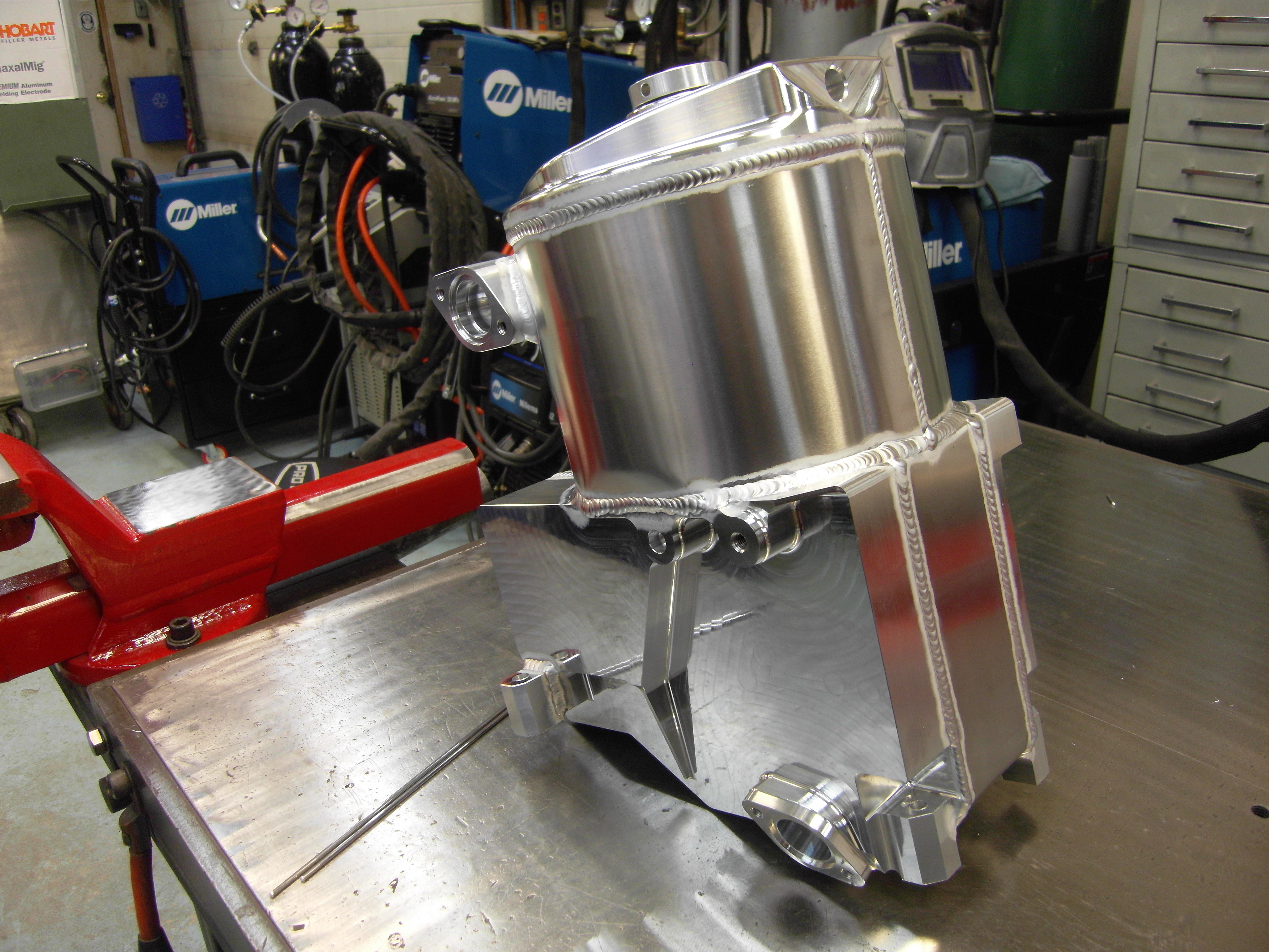

Got it figured out pictures of tungsten's E3 over Alustar and pictures of Ford GT dry sump oil tanks also torch handles.

Some of the setting I use with Alustar tungsten's on the Ford GT oil tanks.
Aluminum .060 to .080
Amps set to Max. 155A
Tungsten Alustar 1.6mm to 2.4mm
Triangle wave EN & EP same
Balance 72
Freq. 120
No. 7 quartz nozzle
Argon flow 25 CFH
Rod 4943
Aluminum .125 to .250
Amps set to Max. 290A
Tungsten Alustar 2.4mm to 3.2mm
Adv. wave EN & EP same
Balance 74
Freq. 140
No. 7 quartz nozzle
Argon flow 25 CFH
Rod 5356
Balance 72
Freq. 120
No. 7 quartz nozzle
Argon flow 25 CFH
Rod 4943
Balance 74
Freq. 140
No. 7 quartz nozzle
Argon flow 25 CFH
Rod 5356
AC Waveforms
Advance Squarewave: provides a fast freezing puddle, deep penetration, and fast travel speeds.
Soft Squarewave: is used for a soft buttery arc with maximum puddle control and good wetting action.
Sine wave: is for customers that like a traditional arc. It is quiet with good wetting.
Triangular wave: reduces the heat input and is good on thin aluminum. It provides fast travel speeds.
28 different Wave forms EN and EP
