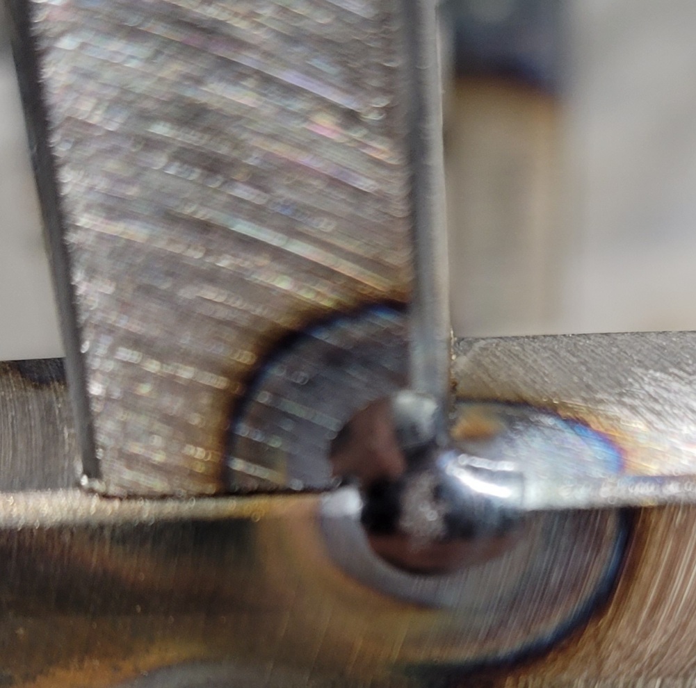

I'm trying to tig weld 1/2" sq .065 tubing together and not having much success so far. Tried tacking w/o filler and just blows a hole in the edge or doesn't create enough heat to connect at all. Had better results when directing the torch a fraction away from the cut edge until a puddle starts and then moving to the edge with a dab of filler. Better.. not great. My question is... am I on the right track or is there a better way? How would you do this exactly? How many tacks and where? How would you tack? How many amps? I'm doing 65amps with a pedal so have tried full and backing off. Also tried pulse. Using a CK9 torch.

A bit more amps, but the real key is to not ramp up slowly like driving Ms Daisy. You need to set your mind to Formula-1 racing mode. Hit that pedal hard and fast. :) And make sure you do not have too long of an arc length, but not too short either. Roughly 1/8" or so. No gaps!

I agree, more amps quickly is the key to a clean Tig tack, took me a while to wrap my head around that.
As far as placement goes I'd tack on one corner then resquare as required and tack down the opposing corner. If this a job that's to be bang on square check again and tack down the last two corners before fully welding.
If it's just something that needs to be together so to speak I go with two tacks and just start where there is no tack and travel towards the tack.

jody mentions it in his video's, he calls them blast tacks.
hot and fast.
the other thing that makes welding so much easier is having an excellent fit up.
something i've been paying more attention to lately, even if its just a hand file to file it flat to get that perfect fit. i find it makes things a lot easier later on.

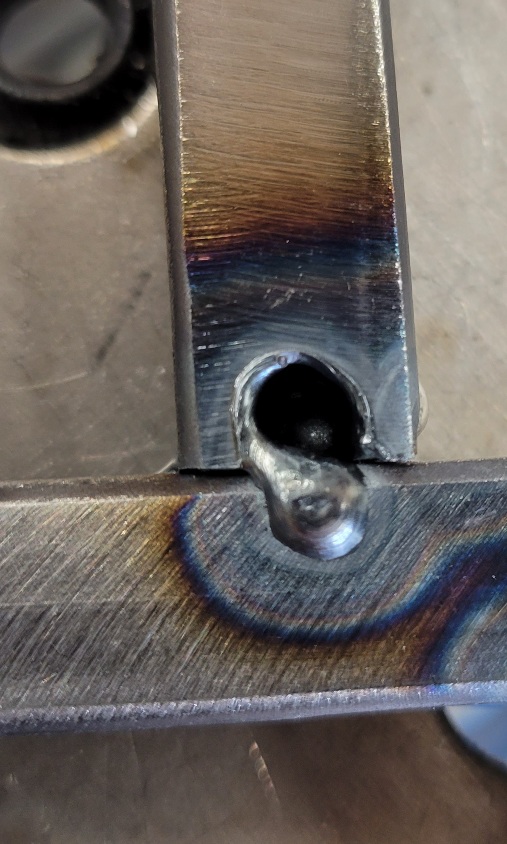

    Sun Nov 07, 2021 1:09 pm
Eureka! Tight fit/F1 Pedal to the metal. May have hung out there a bit too long?
Do not go gentle into that goodnight.
    Thu Dec 26, 2013 12:41 am
    Laredo, Tx
Yup, just have to keep training yourself to let off the pedal as soon as the puddle bridges the two pieces. But what you have should be workable.

instead of tacking on the corners, try it in the centre of the flat. your always going to have that gap caused by the curve of the corner.
just a quick blast tiny wee tack. small tacks are good in case you stuff something up and you can break it off easily.
You mean like that? lol

Hey it's tacked together now ain it? [emoji14]
I think they meant in the flat to flat section though.
For that section if your trying to tack it's a bit trickier because of the natural gap from the radius of the one piece of tube.
You could alleviate that by slightly notching/ coping the vertical tube to allow the edge to come down right. But that's very time consuming to do without some form of CNC tubing processing machine.

noober99 wrote: ↑Sat Nov 13, 2021 11:07 am You mean like that? lol
good example of why not to tack on those type of joints unless you really have to.
you have the tack on the left side which is good. do that on the right hand side, then you can weld out those sides.
make sure you finish around the corner a bit because thats the starting point for the difficult side.
welding on an edge takes a lot less heat before it melts away. so to weld that joint you need to focus your heat on the other side, on that rounded shoulder.
what compounds it is its quite a wide gap to fill as well. some will run a bead along the shoulder, then run a 2nd bead to bridge across to the edge.
or weave across from the shoulder but making sure you don't over heat the edge.
if for some reason you needed a tack on that side, you would tack on the shoulder and add another tack on top until you bridge across the gap.

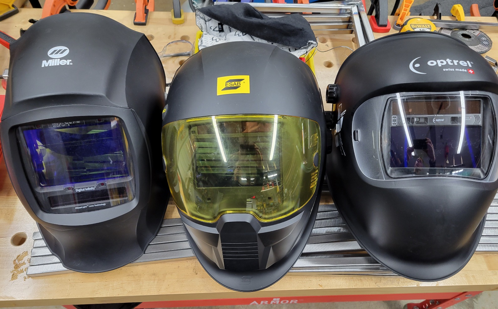

Did not know about the arc start away from the filler.. have not been doing that. Thanks! Also hey Oscar, picked up a Crystal 2.0 per your recommend and have to say wow... what an improvement over what I have now which is an ESAB A50 and a Miller Digital Infinity. It's not a night and day comparison but it is to my eyes... enough improvement to make a difference in my ability to see what the heck I'm doing. Now I have to decide which helmet to ebay away. The Miller is nice but heavy so might be the one to go. Anybody have both of these and can decide for me? The Optrel is light as a feather...
