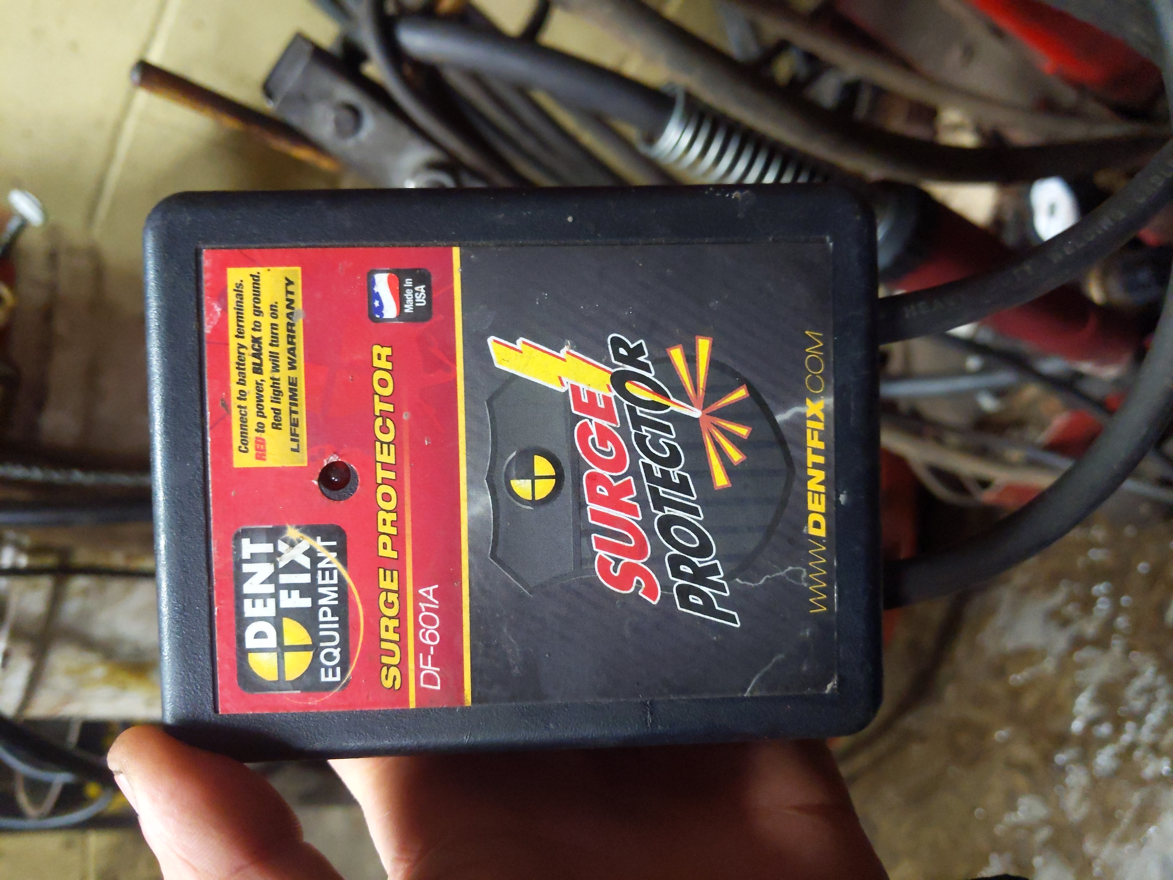

Just buy a isolator. The mechanics at work got this little gizmo box with two jumper leads they pop onto the battery while welding on the vehicle.
They've been using it for years now and havnt had any issues.
Or the free way like others said just unhook the battery.

Toggatug wrote: ↑Tue Feb 15, 2022 7:40 pm Just buy a isolator. The mechanics at work got this little gizmo box with two jumper leads they pop onto the battery while welding on the vehicle.
Well, it can't be a short so it must be an RF bypass - perhaps with over voltage protection.
Do you have more details?
If I did that, I would also be tempted to short the leads together.
its not an isolator its a spike protector. they tend to use them these days because disconnecting the battery can cause or sorts of ecu gremlins. eg ecu self corrects for leaking throttle, disconnect battery looses that data. the ecu will self correct all over again, but that takes time and in the mean time the car runs like complete crap. "the welder must have damaged the ecu" type claims.

Jack Ryan wrote: ↑Tue Feb 15, 2022 7:52 pm
Jack
I'll go snap a pic of it (I think the brand name etc are still on it but unsure), when tapatalk agrees to cooperate again I'll get it posted.

Pic attached
