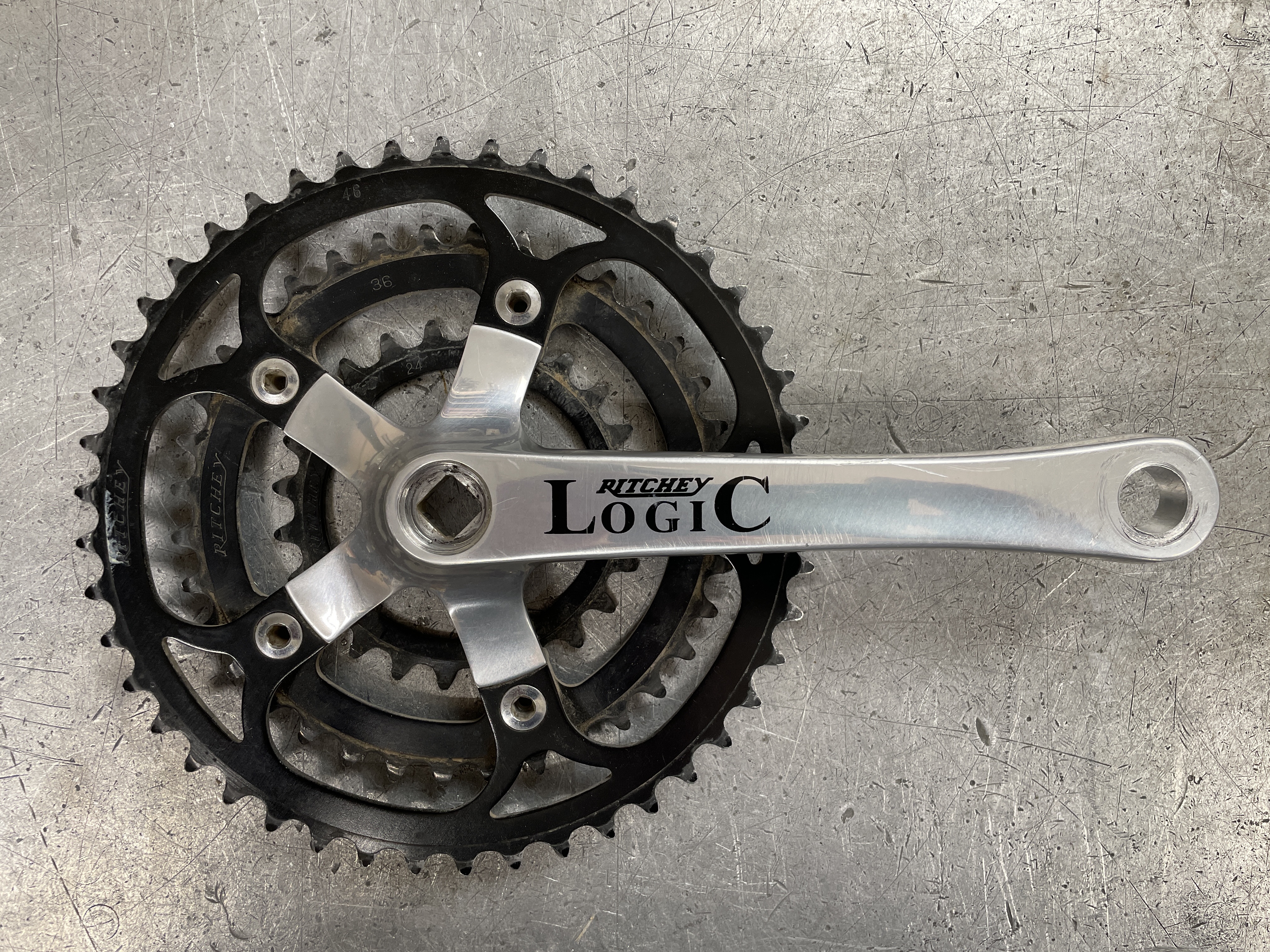

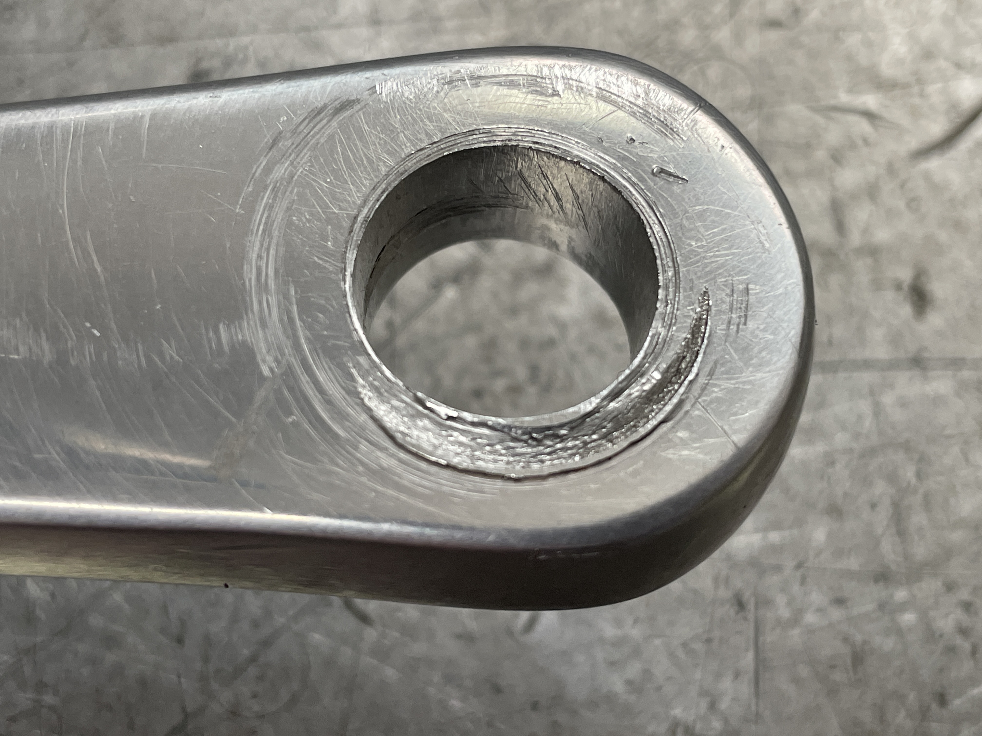

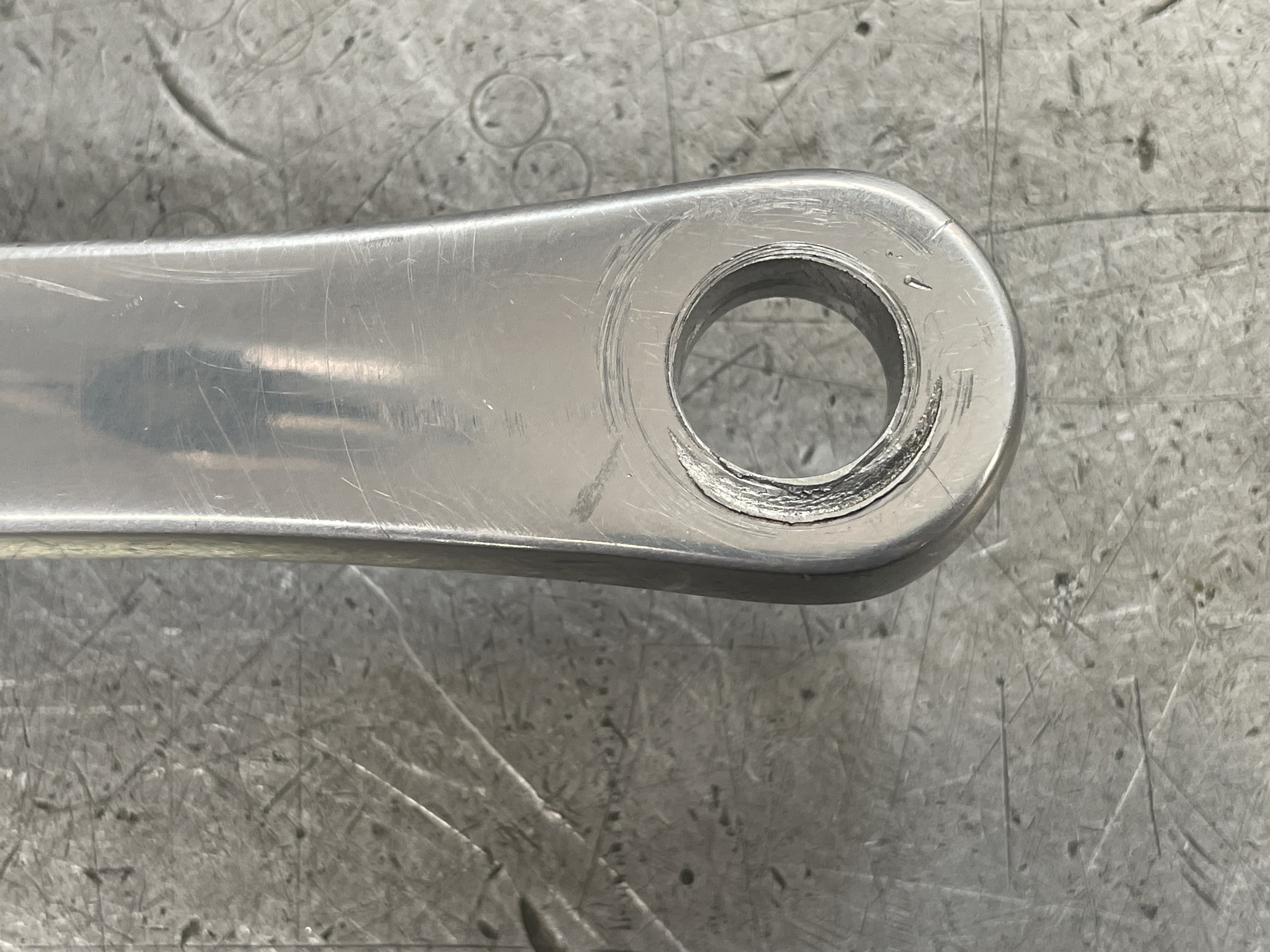

I've attached pictures of the crank arm and close ups of the portion with the smoothed hole. The user did not appreciate that the pedal was loosening until it nearly fell out, thus the damage was to the threads, and the shape of the through hole was affected. One common method of repair is to ream out the hole to 5/8-24 and using a steel thread sert of that outer size to mate with the crank arm. The inside of the thread sert is tapped the proper 9/16-20 size. The problem is that I cannot use that size threadsert because the existing hole had to be reamed larger than the proper exterior dimensions for a 5/8-24 tap. The steel threadsert is a good engineering fix, but I'd still have to fill the hole exterior diameter and redial to proper size for the 5/8-24 tap to use the threadsert. Holding the crankarm in a vise to get a perfect position on redialing the hole is complicated because the exterior surface of the crank arm is tapered with the "backside" about .100 wider than the "frontside"... Nice original design, but poses some challenges to repair.
Now that you can see the workpiece, would you still try the slug method? I do have 1" 6061 aluminum solid bar with a 1/2" center hole that I could machine the slug from...

I don't believe that part is cast. It's forged or other manufacturing process, likely from a higher grade aluminium bar stock like 6000 series. For welding 6000 series, 5356 is indicated or 4943 would be good too. I wouldn't use 4043 for anything, certainly not for this repair. 6000 series also regains alot of it's strength over time, so if you go ahead with the repair, let it sit for a couple of weeks after completion before putting it back into service.

The crank arm is about 1.25" across, so I'm thinking that I could use a 6061 slug in the 3/4" range, leaving about 1/4" of good original metal on each side of the crank arm, and after installation of the slug, drill 3 or 4 dimples around the circumference top and bottom and plug weld them to keep it from spinning out. I'd still have enough room to cut threads for and use the 5/8-24 steel threadsert that has the 9/16-20 standard internal thread for the pedal. It's the long way around the corral, but might be worth it to get the most reliable outcome. 4943 is supposed to have nearly the thread strength of 5356 with the better 4043-like flow so maybe that would be the way to go.
