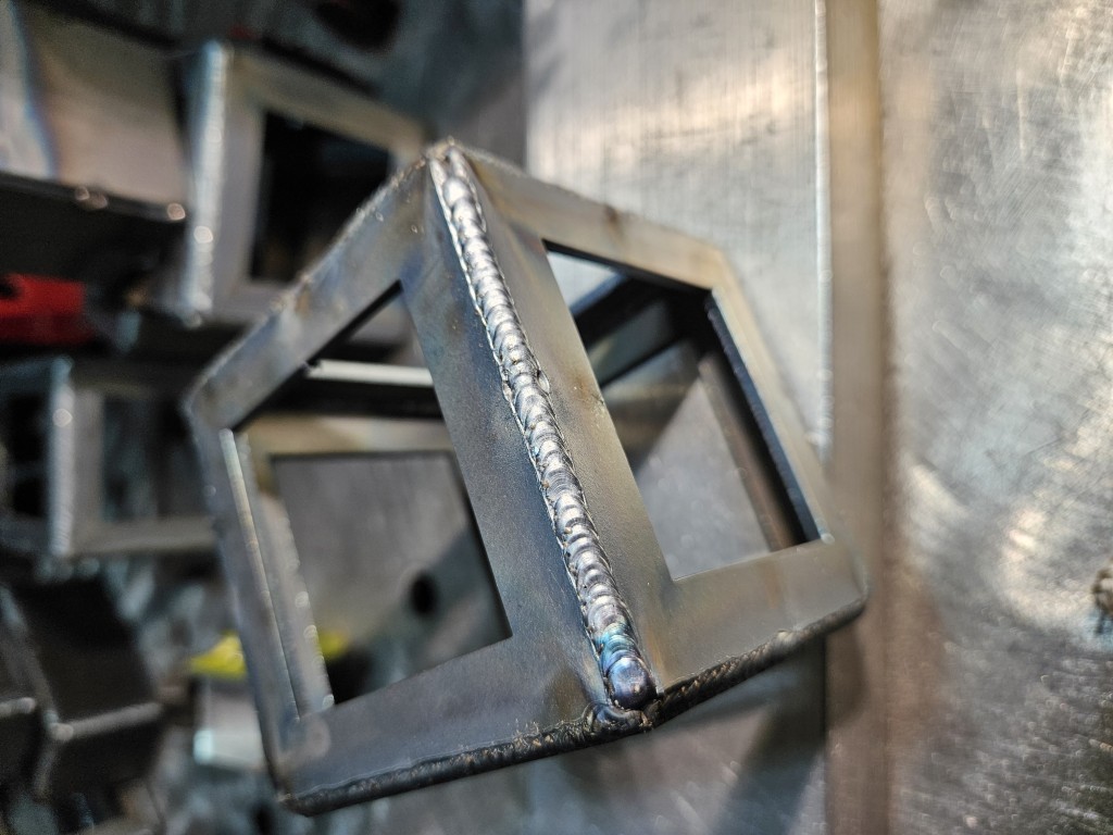

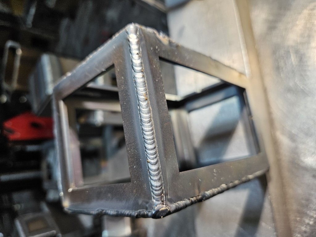

Hi CJ,
A couple attempts at outside corners on an inside out cube. I always have trouble controlling heat on these cubes when using mild steel filler. With the SilBr it is still a bit of a challenge. Quite a ways to go....
One of these pics may be acceptable, the other not so much. (I also need to go back and fill the voids on both at the corner.)

Lower the heat you’re using and you’ll have better results. You almost want to have to “wait” for the filler to melt because the base is not quite hot enough. Loitering heats the base enough to get the filler to melt.
If you’re too hot, you run the risk of melting into the base and mixing the metals.

The metal is 11 ga mild steel. I was using 3/32 SilBr. I started out at 100 A. The last few corners were at 85 A. I could feel what you described.. almost like the liquid filler just soaked up the filler rod too quickly.
Thanks for your suggestions.

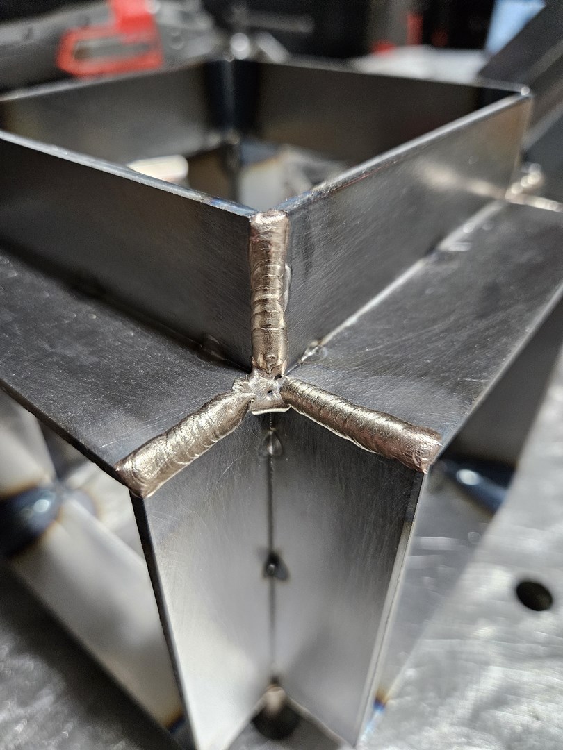

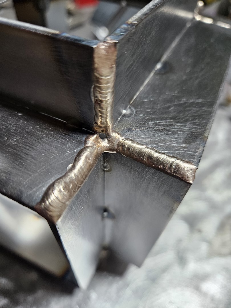

I am attaching a couple of pics. Consistency is hard, too. I know pretty much everything I am doing wrong. Correcting it is the challenge. (The pictures sure seem to point out those inconsistencies more than what I see when just looking at them.)

Outside corners can be rather tricky. If you have an overlapping fit-up, then the joint is really a “butt joint” with two very different edges (end and face) each requiring a different approach.
If you have an “open root” (where you have held the edges back leaving a notch, that’s much easier. The trick then becomes deciding on whether you want the filler to nip the top edge or not, fill only the root, or encompass both edges.
Either way outside corners are trickiest in my book because the shielding gas is “split” by edge. So a really tight arc is mandatory here which introduces the potential for dipping the tungsten. Many people reduce their cup size to help the gas coverage here.
Your beads look fine. Sure, the spacing isn’t perfect, the filler looks a bit cold (maybe add 5-7 more amps) and you’ll get a better wetting-in of the dabs. But overall, you’re doing great.you can either up the amps, drop the filler size, or try to use a little less of the filler introduced into the puddle (higher level skill). I’ve seen blokes weld 20ga sheet outside corners with 1/8 filler but you’d think they had used 0.045. Super talented welders can weld anything with anything and it always looks great. I’m not in THAT crowd.

The way the blocks are set up, they are more like an open root. I thought maybe the welds looked too hot, rather than too cold. Thanks for pointing that out. I have been focusing on keeping the HAZ as narrow as possible. Seems like I am chasing what's optimum. I'll try upping the amps a little knowing I need to move a little faster when I do.
I have been using 3/32" filler when there is good fit-up, and 1/8" when it's not so good. Just for comparison I'll try 1/16" filler, too. The whole feed process is still hard for me get comfortable with. I know it will take more time. I've always been a slow learner.
I'll also try a smaller cup size. All of what I have been doing on the outside corners is no. 8. I'll try bumping it down and see what happens.

Don’t worry so much about the HAZ, focus on the puddle. Outside corners splitting the shielding gas will make the HAZ a bit unusual.
From what I can see, I would slow your travel speed not increase it. Cold welds can be caused by racing ahead and you’ll get less defined ripples as a result. Use the filler rod to chill the weld puddle if you’re getting a bit hot. Stuff the rod in there and see how much more control you gain.
