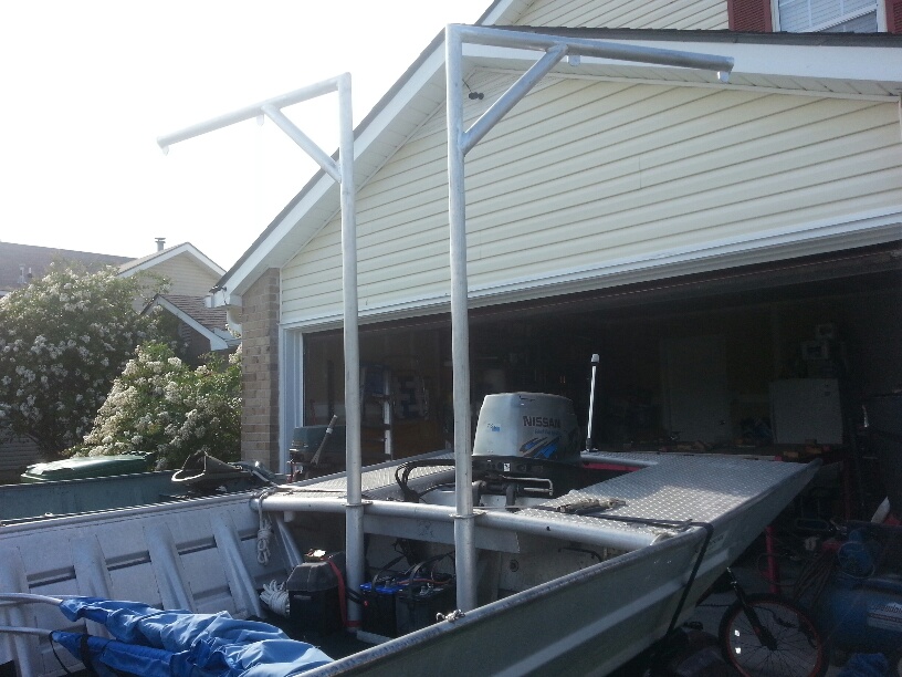

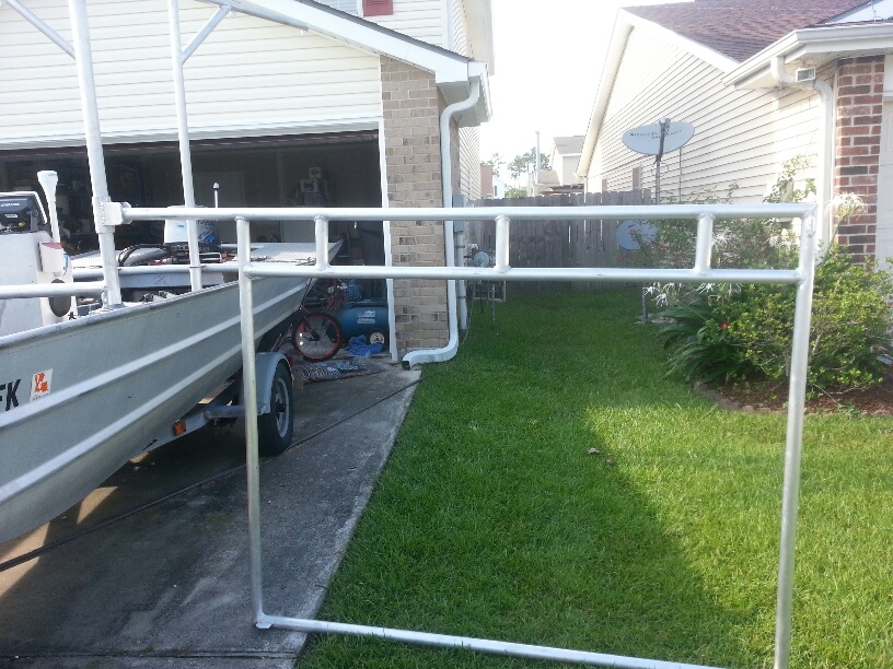

heres the finished project . not to bad I did however go over my quoted time frame of about 6 hours , but its my first paying welding job on my own . made a few rookie mistakes but am pleased witht he way it turned out when I have the nets put on and rigged up ill post more pics . once again thanks again guys for all your advice and help .

Lookin' good, Countryboy!
There's always a learning curve the first time you do something, and it's rare two jobs like this will be the same.
When doing something for the first time, I like an old maxim from Thomas Edison. However long you think it will take, double it and add 10%. Sometimes this is remarkably close, but it almost guarantees you won't underestimate time on a job, even when you run into the unforseen. The number may be impractical for bidding, but should be in your mind when you bid, because rarely does everything go as you expect.
How many hours did you actually have in it, if you don't mind the question?
