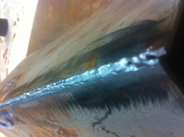

Here's my experience I was amazed how easy the arc was started and stayed going the outside corner was pretty cool I just made little circles and melted parent material in to the weld adding filler was way harder than I thought . I didn't expect it to stick like it did when I didn't place it directly into the arc .when I get done here I will watch some more of Jody's vids . Inside corner really sucked the travel speed and filler placement is tough. Heres my questions my tungsten seamed to over heat quickly does th argon help with cooling . I was running 20 cfh I'm sure my diping didn't help either .I need to make some motor covers tomorrow out of 14 ga so that will be some more practice
3/32 tungsten (red)
Here's my goal I want to be able to do some SS plumbing work in our plant and on our trucks to get rid of leaky poly crap fittings and I think tig might be the answer if I can get a handle on it and maybe some of my sheet steel work could be done with tig also if I'm out of the wind ,who knows

So give me a few reasons why my electrode maybe melting to fast or tell me where to look

You say you're melting tungstens? As long as the ground clamp attached to your torch is on the "-" terminal of the machine (and by inference the stinger you're grounding the table with is hooked to the "+" terminal of the machine), you shouldn't be melting tungstens. Sure, they'll round over some when you "dip" them, but on a good day, I can TIG the better part of 8 hours without a sharpen.
If the attachment is correct, it's possible you're using too small a tungsten for the job, or may have mixed some pure tungsten in with your alloyed stuff. That machine will probably be happiest with 2% thoriated, or 2% lantanated.

I think I might of made it 8 minutes between sparpenings today , doing a little better. I was wondering how long they lasted for you guys . I turned down the amps today and tightened up the arc and that helped a lot after a bunch of practice runs I even welding up a pin hole in heated power washer coil for a friend pressure checked it and it was good . And got some practice with thin stuff puting the shield back on I think it was 18ga . Did a vertical up on some 3/16 flat stock really amazed how well it went I just power washed ,degreased to get rid of fuel oil soot and ground out like I was going to mig weld .
And yesterday I was grinding the tungsten the wrong way ,i got that fixed today and the arc goes where I want it . Just a really amazing process . With out welding tips and tricks I would of never tried to run a tig from the Lincoln eagle on my service truck . I think it's pretty damn cool

Ok few problems today I think I can blame it on my crappy clean up . Mill scale and freshly lubed snap clamps
Would that contribute to tungsten degrading quickly ? So I could sleep tonight I built a tray for my service truck after work tonight and cleaned everything very good probably to cold on the long welds but the ends are nice , it will be fine for holding rulers and pencils

I too have been having an issue with my tungsten melting. It looked lke in the picture of your welder that it was a generater type machine, correct? If so are you scratch starting your welds? I did see a trigger on your torch but I'm assuming no High frequency. I'm using an old transformer welder and definitely have it hooked up right and I'm scratch starting on carbon steel.
I've tried Thoriated ,Lanthanated, and Cerriated and all have melted faster than I thought they should. I'm welding new meltal with light rust, in all positions, even literaly standing on my head, sorry that's when I fell off the step ladder, it's 1/8" angle and I'm welding at around 65-70 amps. I've ran my argon anywhere from 15 to 25 CFH without much difference.
Because of the places that I'm welding, like at arms length @ the top of a extension ladder and using my torch hand to both hold myself up and weld, I've been dipping my tungsten quite often. That's not an excuse, it's just a part of the equation. I'm making an enclosuse inside of a large plant building. What I did find is that when I can get a chance I strike the arc like a match off the filler rod and not the angle, I pick up less crud on the tunsten and it stays pointed a little longer without melting.
I'm using a brand new CK flex-loc torch with a stubby gas lens and a #8 cup. I tried a #6 cup but there are alot of drafts in the building and I don't know if I'm not keeping the electrode cool enough or what. Also to Steve's point I'm using a wedge collet that can't twist and I only have 3/32 parts on hand.
When I weld at home I too can go most of a full day without sharpening my tungsten, but I have HF and a foot pedal or thumbwheel to start the arc with. Next time I have a carbon steel project at home I'll try sratch starting and see if I have the same problem.

Thanks for the reply yea I'm scratch starting the arc my switch is not hooked to any thing I'm welding 14 ga and switched to 1/16 red electrodes now I want to try some small filler how much smaller I'm not sure so I will get a little assortment of sizes
I'm having a little trouble lately with sharpening a electrode and starting a arc with out turning the gas on first so I spend a lot of time grinding . I'm not super frustrated yet because when it goes well its worth it . This is mostly a test to see if I want to go to the next level with a full blown tig setup
