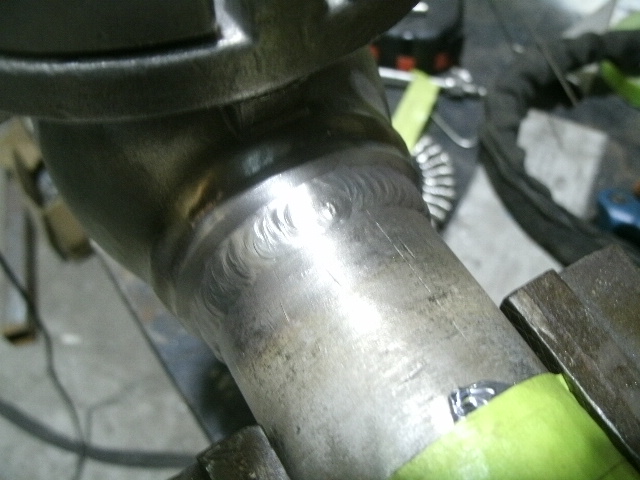

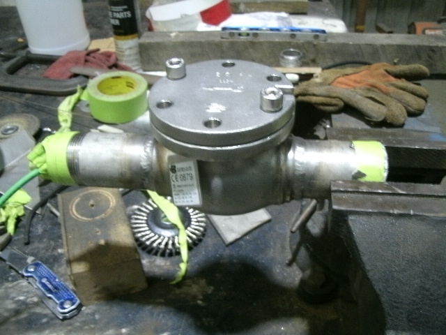

Here's a little weld I did yesterday (well, two, actually, but I'm pointing out the one on the right of the valve... the other side was done on the bench...
I post it not for what it is, but for the jacked-up place I had to do it, half in the mirror...

Otto Nobedder wrote:Here's a little weld I did yesterday (well, two, actually, but I'm pointing out the one on the right of the valve... the other side was done on the bench...
That's great work. I was thinking about your mirror jobs Friday as I was reaching around from behind a structure with the filler while looking thru the front of it. I had no less than 14" of rod past my hand and i was watching the end of the filler shake and then magically stop shaking right as soon as I was ready to hit the puddle.
What a difference a day makes, when you don't weld every day!
Here's the weld I did the end of Thursday:
Note the ragged steps and undercut... On the side I did right-handed, no less. I did not have time to fix this until the next day.
Here, on the other hand, it the first weld of Friday, the opposite side of the valve:
The left-hand work looks little different from the right.
This was all bench work, mind you, so Thurday's weld was no harder.
Here it is in context... Stub-outs on a check-valve:
I've not yet fixed Thursday's weld (on the left).
Here's a li'l more context, and a silver-braze I said I'd post...
The valve is re-used, and was originally TIG-brazed with silicon-bronze, making the de-brazing/salvaging of the valve the most challenging part. At the top of the image is the check-valve from the last post.

I do the same thing. But then when I look at it the next day among 20 other welds, it seems to go away or it fixes itself somehow. :) Those welds look pretty damn good to me!
I did some today and I was going to put the interchangeable sub-assemblies to where the best half of the welds were facing out. When I went to do so, there was no real apparent best side. Turns out that I was nitpicking some really minute details. This time of the year I have to have fans blowing on me. Between that and everyone's propensity to make even the most unimportant (pleasure boats, really are not very important) jobs an emergency, screw em. They get what they get. Holiday's coming up and there is a line of 'last minute' folks that "need" their boats by Friday. There's gonna be a lot of 'one chance to get it right, or else you're stuck with it' welds this week. They better hope I am on my game.
True.
I'll pick a weld to death when I finish it, yet the next day, it looks pretty good. The problem I had on that check valve was seeing two side-by-side I'd done the same way. In the pic where I showed both sides of the valve, I intentionally took the pic before fixing the weld I wasn't happy with, and while I might accept the poorer weld on it's own, seeing the contrast made me fix the first weld.
I know, I know... I've said it before. We like to call ourselves craftsmen, so we tend to be our own worst critics. OTOH, the only way to improve is to set your standard higher than you currently achieve.
