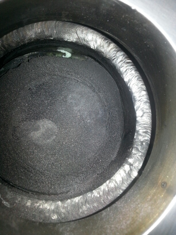

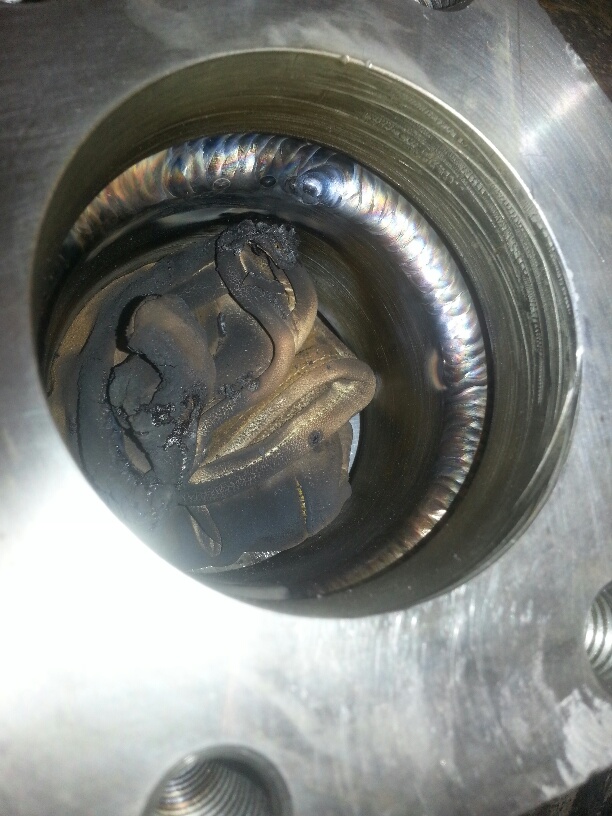

Once you do one you get stuck with all of them . Apparently since the place that builds these barrels cant get the weld rite I get to fix all of them that we get
- After
- 20131218_112539_resized.jpg (171.9 KiB) Viewed 5784 times
- Before
- 20131218_150703_resized.jpg (168.81 KiB) Viewed 5784 times

countryboy1127
- countryboy1127
Joined:Wed May 01, 2013 7:28 pm
Thanks mike . It is a pain welding over machining oil especially when its trapped under non fused welds . I had a few problems with porosity on a couple of them but got it all sorted out
