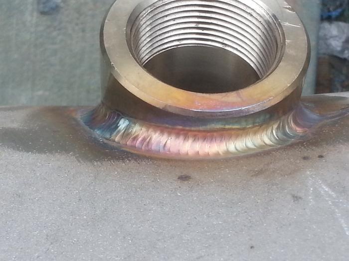

First welds of 2014. Happy new year!
Derek G by Zanconato Custom Cycles, on Flickr

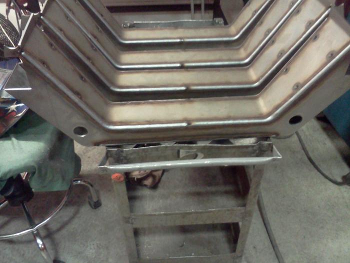

Seal welded some winch mounts
countryboy1127
    Wed May 01, 2013 7:28 pm
Got to weld a little stainless today

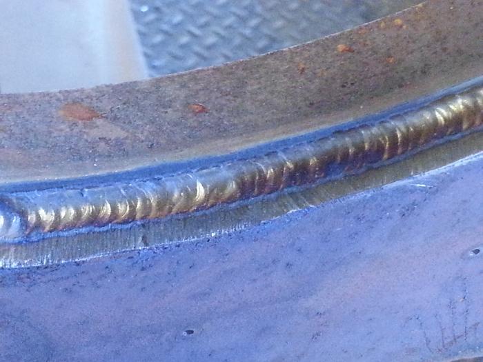

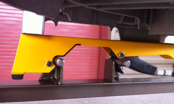

3/16" x 1-1/2" mild steel, TIG, 145A peak, 1/8" 2% Lanth, 3/32" ER70S-2. Some welds came out better than I deserve. The ones visible here are more typical for me - more practice is needed, which was half the reason for the project. Getting the inside corner of the angles clean was a real chore, and it shows in the welds.
Reason for the odd mounting pegs is so the saw can be easily moved between this stand in the shop and an aluminum sawhorse that Dewalt sells as a portable stand. That stand is 5" wide with a 1/2" bullnose, so 1/2" rod worked great here.

I had the benefit of using a StrongHand table for this project, and man is it nice!

Dont be too hard on your self for yhe welds inside the angle iron. Its quite difficult. One of those things that learning to weld with both hands will help. When in a tight spot, I put the tig torch in and weld out.
Mick

Yeah, I'm taking it in stride. I'm actually really pleased with the results, considering my experience level - I just have a lot of practical skill to gain. The welds here are very functional, not too ugly, and I'm downright tickled that the project came out square and flat.
