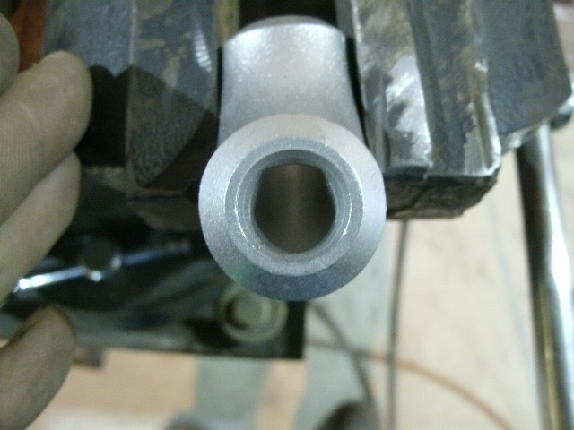

Well, it ain't Monday, but here's the view of the ell. The taper to pipe ID is obvious (so, yes, smaller ID in the ell), as is the odd "horseshoe" profile, that matches the variation in HAZ in the previous picture.
Steve,
Interesting, I personally have never seen a one like that. Anyone care to explain why it is made like that? I could look it up but I will let someone else answer a question for me, change things up
I'm sure it's simply an efficient mandrel fo bend something this heavy on (and for all I know improves teh flow around the ell).
In other words, I have no idea...
Gave me a good laugh though!Otto Nobedder wrote:I'm sure it's simply an efficient mandrel fo bend something this heavy on (and for all I know improves teh flow around the ell).
In other words, I have no idea...![]()

Superiorwelding wrote:Steve,
Interesting, I personally have never seen a one like that. Anyone care to explain why it is made like that? I could look it up but I will let someone else answer a question for me, change things up![]()
Maybe something to do with the contraction of the metal when it gets hit with rapid temperature changes.
Based on where it is being used I would expect there to be a lot of that.

Steve,
I was checking out all the S/S fittings in the rack and I didn't find any with that D shape. I only have up to sched. 80 here but I've been working in another plant that's a liquid plant a couple days a week. Monday when I'm down ther I'll check out some of the fittings in the old high pressure pump shop and see if there are any sched. 160 and if in fact they are also D shaped like yours. Those are a first for me, and we do weld quite a bit of butt welded fittings in the small process piping.
If I get a chance next week I'll ask our piping guy (one of the sharpest guys I know) why they're made that way.
