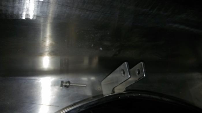

I'm not sure if I am in the right area, but can you help me list all of the polishing tools that a fabricator should have?
we are having trouble on some areas that we cant fully polish.(hard to reach areas, narrow, reversed corner)

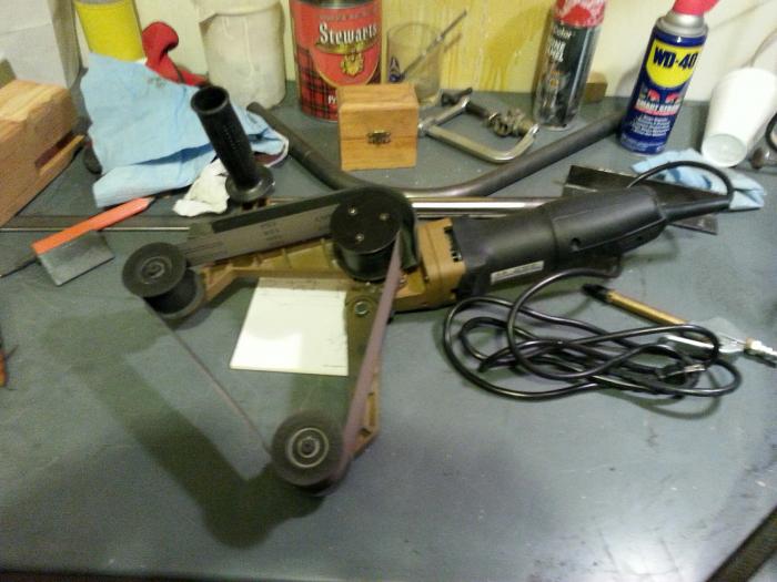

A dynafile is an awesome tool for those tight reverse corners...
Dynabrade has tons of products for your purpose... Have a review if their site:
http://www.dynabrade.com/dyn10/index.php
I am not affiliated with them; I've just used a few of their tools with great success.
I'm not sure how fine a grit is available for the belts, but I used them a lot building SS handrail. They also have polishing products and tools for tight spots.

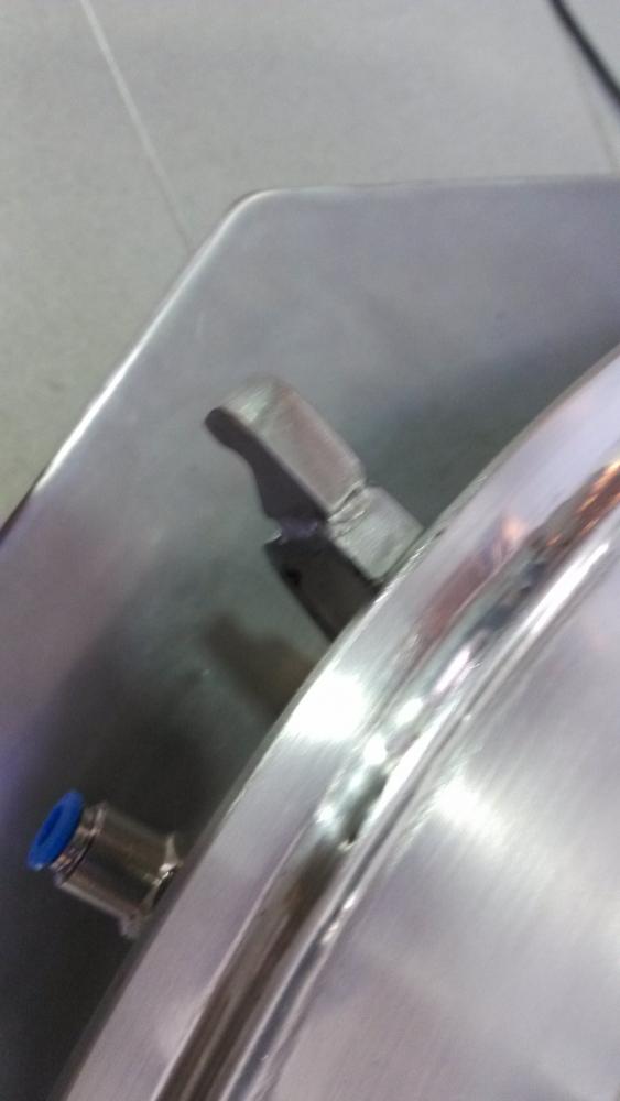

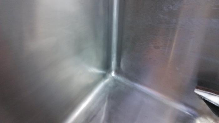

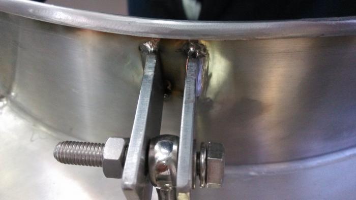

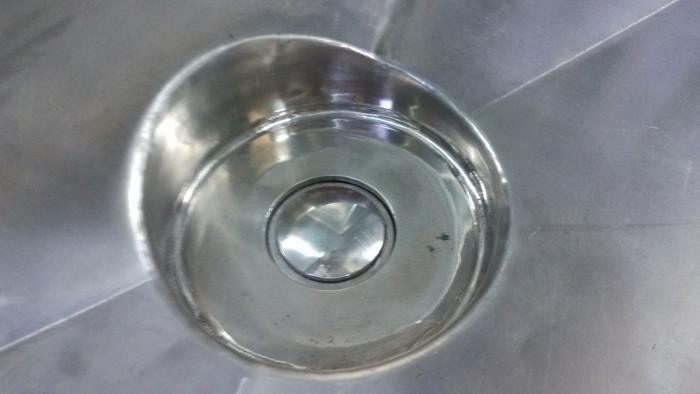

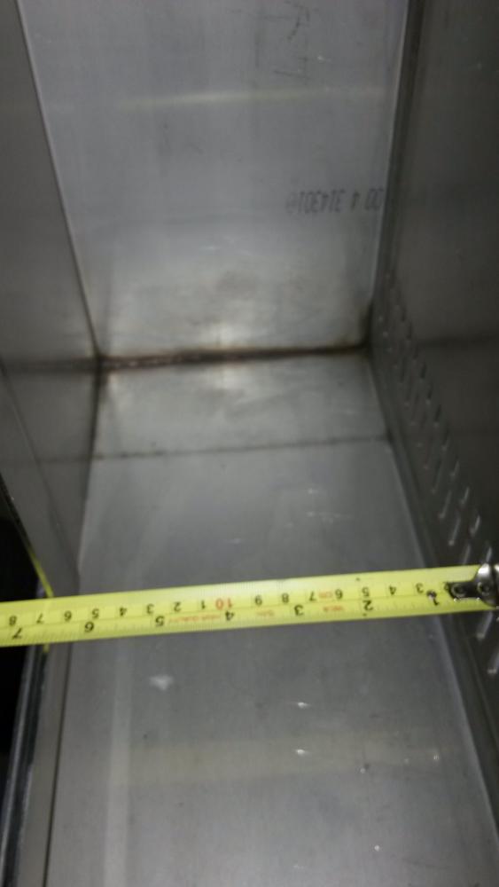

Please see attached picture
I would appreciate if you can give the exact model#
thanks!
thanks!
- rounded small
- IMG_20140712_112353.jpg (24.57 KiB) Viewed 3045 times
- hard to reach area
- IMG_20140712_112259.jpg (23.04 KiB) Viewed 3045 times
- hard to reach areas
- IMG_20140712_112248.jpg (18.61 KiB) Viewed 3045 times
- hard access
- IMG_20140712_111217.jpg (29.78 KiB) Viewed 3045 times
- IMG_20140712_110531.jpg (37.38 KiB) Viewed 3045 times
- inside diameter usually 18mm to 25mm
- IMG_20140712_110409.jpg (16.94 KiB) Viewed 3045 times
- IMG_20140712_110403.jpg (27.03 KiB) Viewed 3045 times
- reverse corner
- IMG_20140712_110256.jpg (18.48 KiB) Viewed 3045 times
Those examples I would agree are difficult to polish - it depends a bit what finish you require & the size as to the most effective method - just to remove weld color then one of the electrolysis brush type cleaners would work well - if the part is not too big then a vibration polisher tank would give consistent though not mirror finish on the entire part - if the part is big then consider media blasting with corn cob / walnut shell ( available pre-loaded with white rouge ) - I think most production work relies on the material being ordered in with the required finish so only minor clean up is needed on welds & localized HAZ - often done by electrolysis so no hand polishing is needed as it takes time - one off stuff is always an issue - it often takes me longer polishing boat parts than making them but I mostly use only conventional mops / compound.
astro pneumatic also sells thin air-powered belt sanders that you could probably adapt for polishing.
I use this one...
3M also makes one specifically for polishing, but get ready to shell out some bucks for it...they sell attachment arms for it, where you can attach 3M polishing belts
http://www.rshughes.com/video/all/Metal ... essel-arm/
I use this one...
Oscar,
I've used the tool you posted in the first picture. We called them "Dynafiles", but I suppose that's from a brand-name, like calling a reciprocating saw a "Sawzall" (Milwaukee brand).
The belts for those go quite fine. I used them primarily on SS handrail, banistrades, and balustrades, to get in the corners and buff the welds.
I have a generic air belt sander similar to the " Dynabrade " type & have found " Scotchbrite " type belts for it which help with blending especially on brush finish - I don't own any Metabo gear but it looks good if expensive - below is a You Tube link of some of the tools they have for stainless finishing on tube - there are others for flat parts - the results are impressive considering what he starts with - can hardly call it a weld ! maybe it was deliberate so the finishing looked better.

I don't have any suggestions, but I'm watching to see what others come up with. Those are some tough places to get into...puts some pressure on you to place some nice beads first time around because there is no going back to dress anything up as tight as those places are.intron12 wrote:any comments guys?

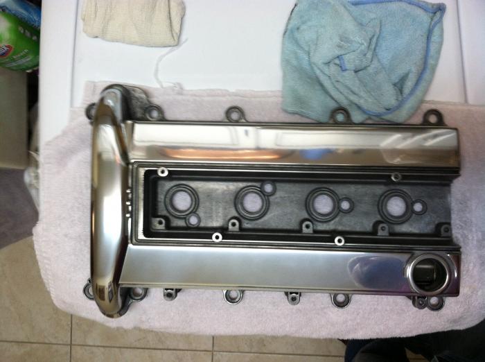

I found that for the basics you need a benchtop buffer,
An electric die grinder, a dremel kit, several different buffing bobs...
I have done several aluminum valve covers in the past. I found that a lot of them had casting defects; such as porosity. Which would make it ugly if you try and jewel your metal to have a mirror reflection.
For tight places- about the only thing is Dremel accs. Or get a damn good compressor with a very high Cfm rating.
Jewelers and dentists have the tools for tight places. So check online for what they use.
- image.jpg (48.13 KiB) Viewed 2655 times

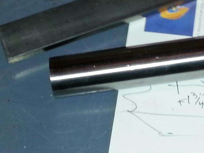

OK Brian, I haven't had this tool long and haven't used it but just to test it. I got it for an upcoming project 160 feet of 1" stainless tube. the price polished was up to the moon over $2,ooo for mirror finished 316L 1" with .o62 wall I just about shit. the price with a mill finish is about $400. so I found this tool a chinese knock off of the metabo tube sander polisher. The quick test I did was on 1" crome molly tube with a nice mill finish. I spent maybe 5 min screwing around. the sander came with 1 80 grit belt, I tried it and it took off a lot of metal to much. so I tried a 400 grit belt. It was the tits did a nice job fast. The motor is a bit loud I think it should hold up fine. the bottom line is the unit only cost $175 plus shipping. The belts almost cost as much $155 plus shipping.noddybrian wrote:@ Dave.
