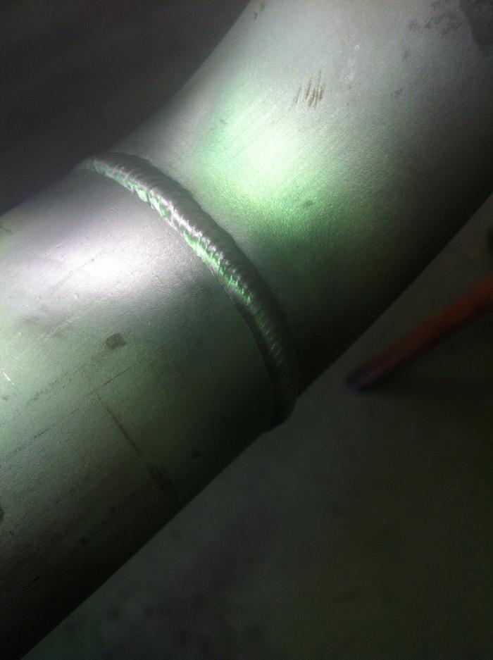

hi guys just a quick upload of some of the work ive done.
i wanted to take more pictures but halfway through my boss told me it was a rush job so only a few pics.

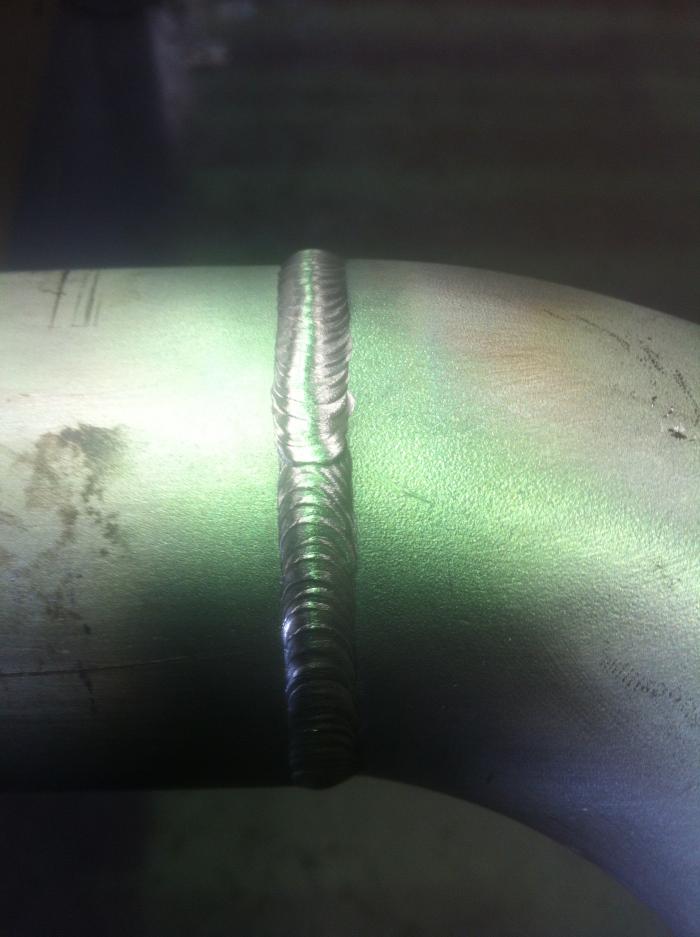

these were welded more or less in the 6g position (it was an aprox 45 angle, you might notice the cap is in a different direction to the root, i rotated the pipe 180 degrees after the root to reduce distortion, but the piece was still welded in the 6g position
fixed 6g when welding left and right hands used

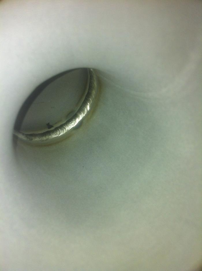

2" schedule 10s 304l stainless steel pipe to 90 degree elbow for a gas line.
i like my gap a bit wider than most but i use a 3.2mm gap with 53-56 amps using 1.6 wire, then 63-68 amps on the cap with a 2.4mm wire. i use a 3.2 gap simply because i like to see the pool flow into the root. plus a saw a example weld done by a welder at a big company and i took the advice he gave he and ran with it (it was one of the best ss root welds ive ever seen).
best way i can describe the technuiqe is slow down, as my mentor says "you cant rush on stainless". im still working on it as i would like a little more protrusion of the root when welding overhead, any advice ill be happy to hear from you.
any questions just ask
thanks guys

- Braehill
Moose,
Again fine job, not many faults to find there. You'll only get better with time and with the short time you have been doing this you seem to be well ahead of the curve. Great work, keep it up.
P.S. I talked about it a little in a earlier post, it's not always favorable to have a lot of protrusion on the inside of process piping. It causes eddies in the flow and depending on what's in the pipe it can cause etching of the weld and pipe. It's usually best to check with the customer on this.
Moose,
I can't find any fault with that. I'm hard-put to find any flaw there.
As Len said, inner reinforcement depends on application, as I've welded with "minimal" inner penetration as a requirement depending on flow, but I'm not your CWI and I didn't read the WPS.
That, to me, looks F'n great.
nice job, I have been a nuclear pipe weldor , and a nuclear inspector for many year, and your welds are as good as any I have seen. Having said that, I would like point out a couple of areas that you might take into consideration; 1, excessive cover pass reinforcement. 2, excessive root reinforcement.( minor IAW the end results).again,nice job,....question, what type of purge setup and purge gas did you use on the pipe joints......... ron
Agreed, just a little too much re-enforcement inner and outer but that all depends on your WPS. Bead consistency looks good.
Any reason you didn't walk the cup? I do both just like hearing what other pipe welders reasons are.. I find walking the cup helps me slow up...
