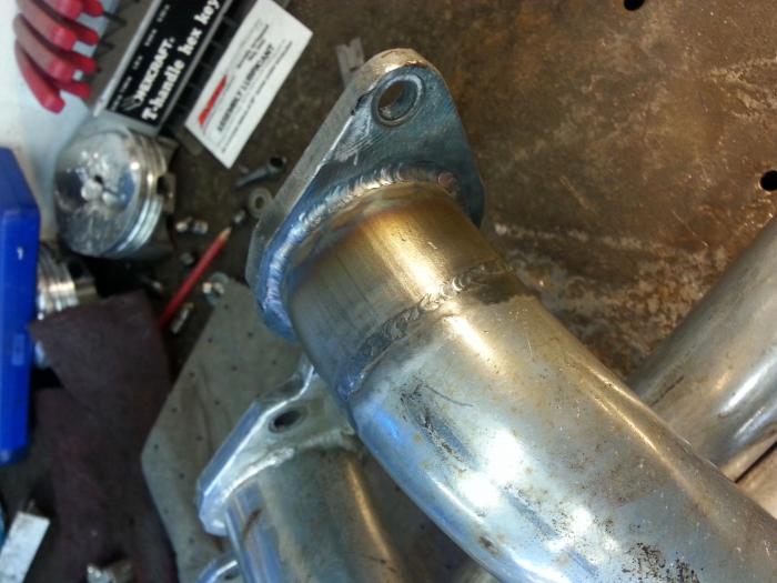

This is what i did today.

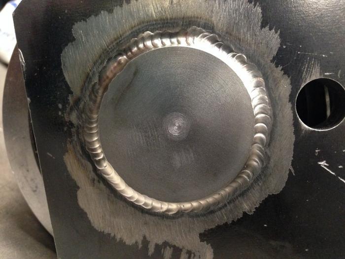

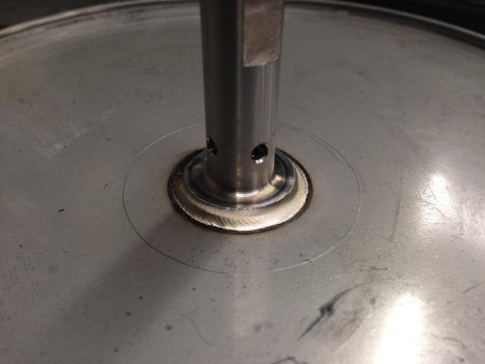

You could be forgiven for thinking I've been making rollerskates for the Hulk. Linear casters required and specifically ordered to be overengineered to the extreme. The trolleys that these will go on (4, 1 per corner as you'd imagine) is required to take 6,500lbs in weight; for a guess each one of these will take double that on it's own!
TIG root with a hot pass over it. I know it looks uneven but the parts came to me with a vaguely uneven prep on them so I levelled it out in the wire run, this was all done on very tight time constraints.
MIG capping run over the top as demanded by the instructed process. (for the record I disagreed with the whole weld process for this job but was overruled) A point to notice is the horrible quality of the MIG wire we're provided, look at all that silica.
BIIIIIIG centre pin going through the bearing assembly which was extremely tight, perfect interference fit.
Which then gets a quick TIG run around it for permanence. (?Yeah, I'm still trying to master going around the outside of circular parts.
Despite the issues, actually quite a fun job; I find that I like multipass work.

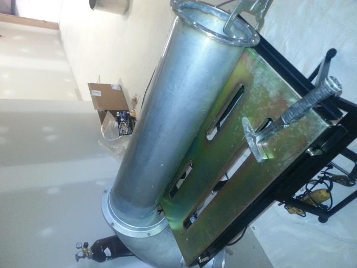

My first on site job for my new business. Stainless exhaust duct for an MRI machine. Its a start.
All done with my AHP alpha tig 200.
