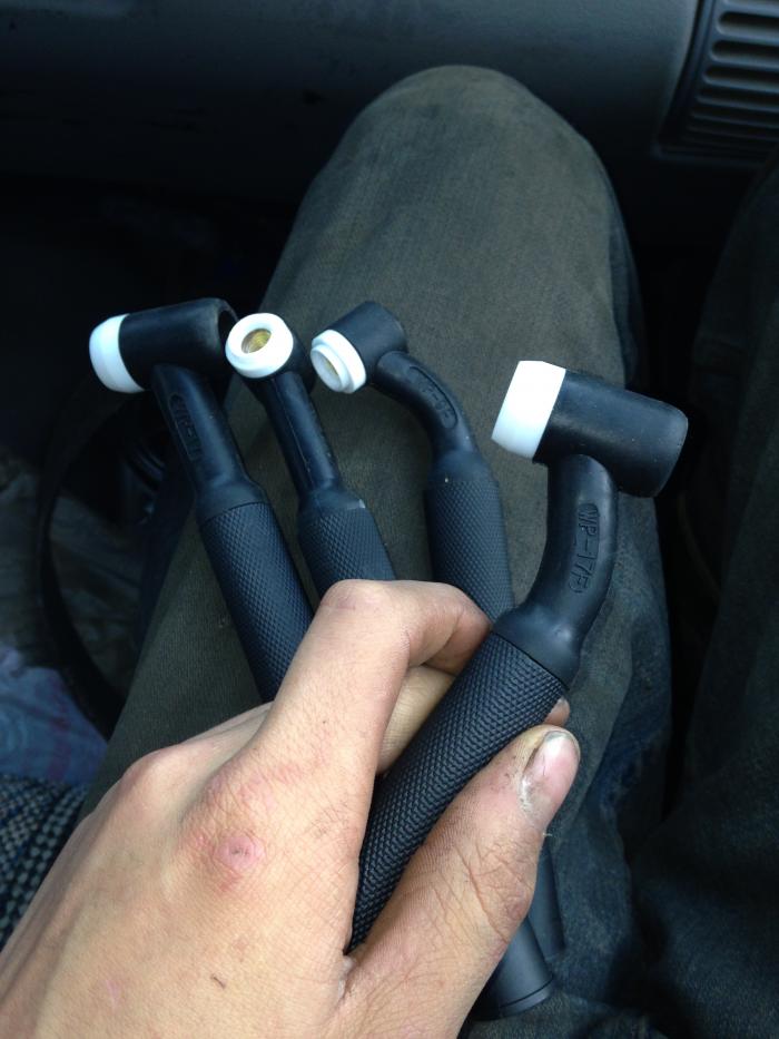

Check out the CKWorldwide website. They specialize in tig components. Their torches are great. I am ordering the FlexLock with the superflex cable. You can adjust them to any angle, and they are rigid, so you can walk the cup if you want. Jody did a video on this torch. Check it out!TwentyFourSeven wrote:The tig torch I have is Wp17 I do believe. It is not a flex head. I would like to switch just the head of the torch for a flex head as I am having to weld in some difficult positions and I think it will help me. Have any of you guys done this? If so do you have a reliable link to the part I am looking for? I have found them my self but would rather go with one someone here suggests. Thanks guys.
Here's the 4 torches I bought.TwentyFourSeven wrote:That's the one I was looking at but wasn't sure. I figured for $10, "what the heck" so I went ahead and ordered one.
9, 17, 9f, and 17f....
Look like good torches.
My advice to air cooled tig torch owners.
Throw your regular torches away, and buy a flex head....and a tig finger.

I saw the "F" designation on the torch name and looked it up... and see there are "F", "V", and "FV" flavors. I'm guessing "F" is for flex head, but what are V and FV?
Dave
aka "RTFM"
aka "RTFM"
Correct, F stands for flex and V for a manual argon valve.
(Valve required only if welder isnt equipped with a solenoid for the gas.)
dirtmidget33
- dirtmidget33
V=valve on torch bodyArtie F. Emm wrote:I saw the "F" designation on the torch name and looked it up... and see there are "F", "V", and "FV" flavors. I'm guessing "F" is for flex head, but what are V and FV?
F=flex head
FV=flex head with valve
