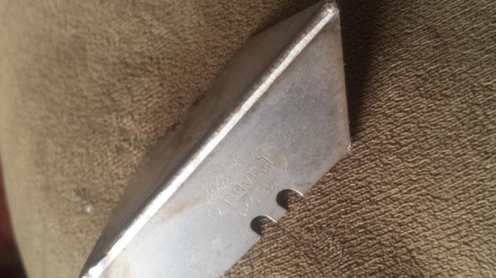

Well, technically, they're welded. 2x Stanley knife blades and 1x cheap azz hacksaw blades.
2mm 316 ss electrode at approx 20 amps. Power arc 200.
Now I never have to do it again.

Mick,
Looks, umm, good?
Did you use any backing material like copper? I plan on using copper or brass when I get to try it. Not bad considering the process really.
